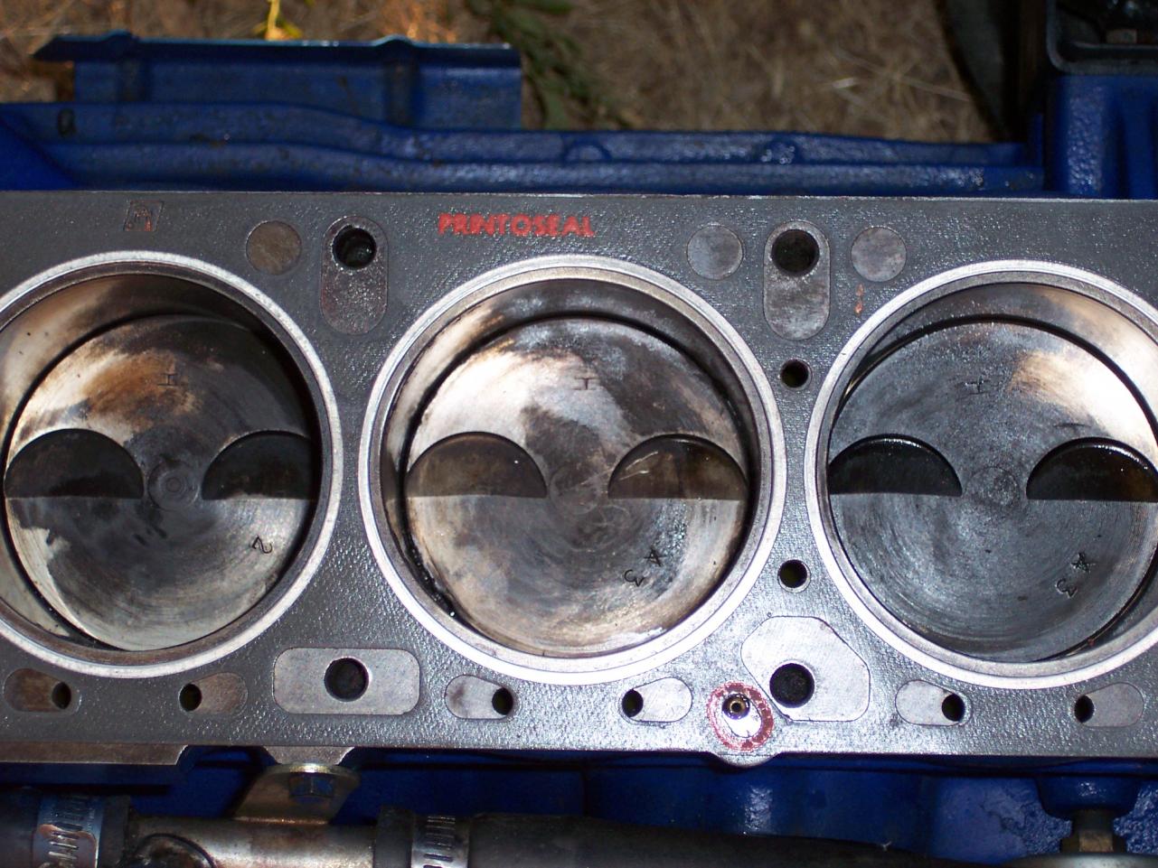

I'm no expert on this, but it seems that if you're running a stock head with stock block, the reliefs are there for a reason. My flat-tops (70) have owner-induced "reliefs" imprinted due to a bad cam install I did years ago. I'd hate to think you'd do the same thing from a different source....

Deck is surfaced, but did Datsun ever come with relief's ?
I once heard that the relief's dont even match up with the valves, to me they are just less compression and more chance of detonation.
