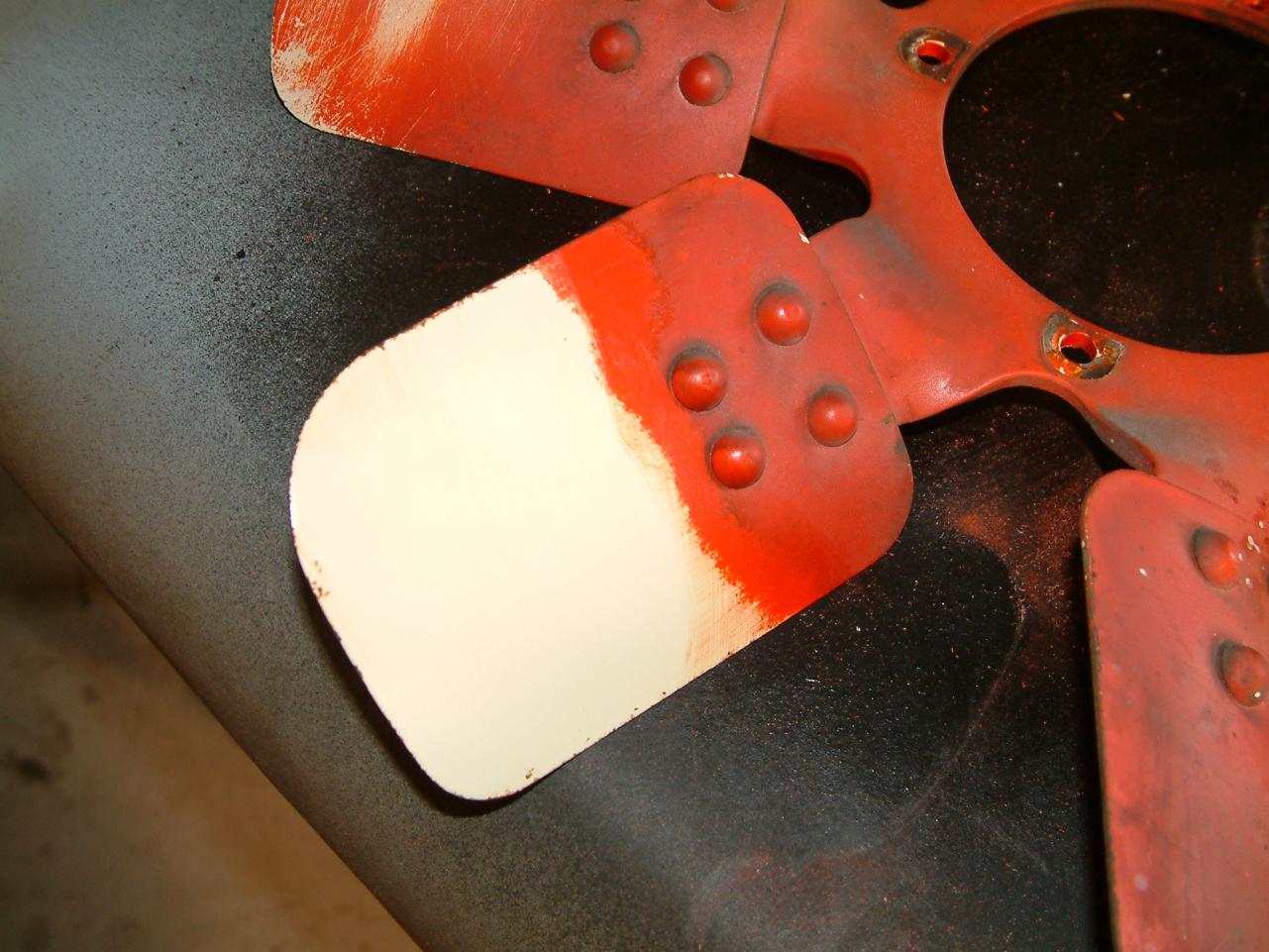

Yes, that's what I figured on your previous advice to me. I hit it with coal slag at 80 psi and took my time. This pressure, combined with some previously used slag, peeled the first layer (orange) off gently and is now gently blasting away the second layer (white). I am about 25% done.
Looking at the next few posts I probably could have hit it with stripper or sanded it down but I'm not smart enough to take the easy way out (stripper) and I really wanted it to be painted fresh from bare metal.
Thanks for all the tips. I will post pictures when done.

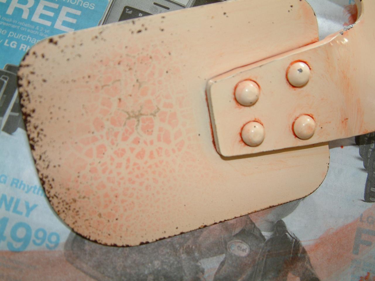

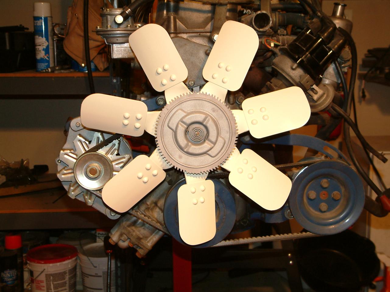

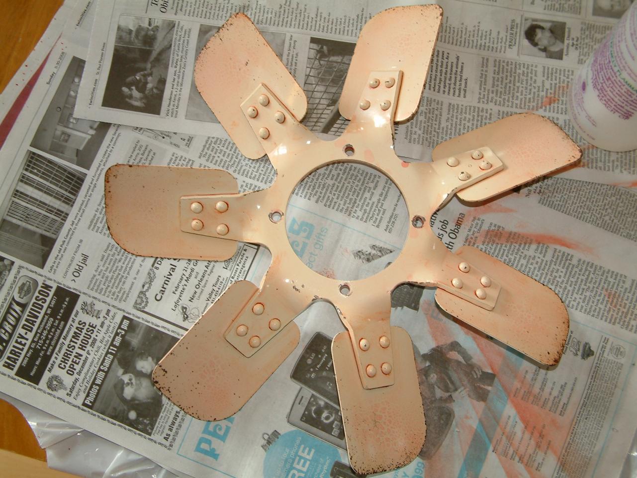

Here are some pictures. I have to say that it looks pretty good. I did end up with a few runs that needed to be sanded down but all in all it turned out nice.
I accomplished this as follows:
Removed the top layer of paint with pure acetone and a rag.
Blasted in a small blasting cabinet with coal slag (black beauty) at 60-70 psi
Was careful not to blast too heavily after the paint came off or around the rivets
Primed it with rattle can sandable auto primer (Rustoleum)
Applied 4 coats of Rustoleum Gloss Antique White (#7794) I found this to be an almost exact match and the old paint looked to be gloss. I sanded after the second coat with 600 and after the third coat with 800.
