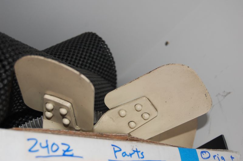

It is a metal fan from an early series 1. I can clearly see the white-ish paint under the poorly painted orange. I am getting ready to blast and prime this tomorrow and was wondering what color to finish it with.

Mine is not in the car right now. (I use a lighter plastic fan for my normal driving.) It is a very creamy color. I wouldn't call it white, more of a very light cream color. The color in the picture looks fairly accurate on my laptop.
Thanks Arne. That is very similar to what I see when I sand off the orange in the thin areas. I wonder if I could find something similar in a rattle can?
Well, I guess I will see if I get another response that has an "exact" color, if not, I will be shopping at 8 tomorrow.

Hi, John.... I had one of those in my hands yesterday, and the color is as Arne and his picture describe it. Unfortunately I cannot help with the color code, but you should easily find a suitable color on the shelf. That should look nice when you are done blasting and refinishing. Show us some before & after pictures.

I used some pure acetone to pull the cheap enamel off the cream and now have a nice sample to choose the color from.
