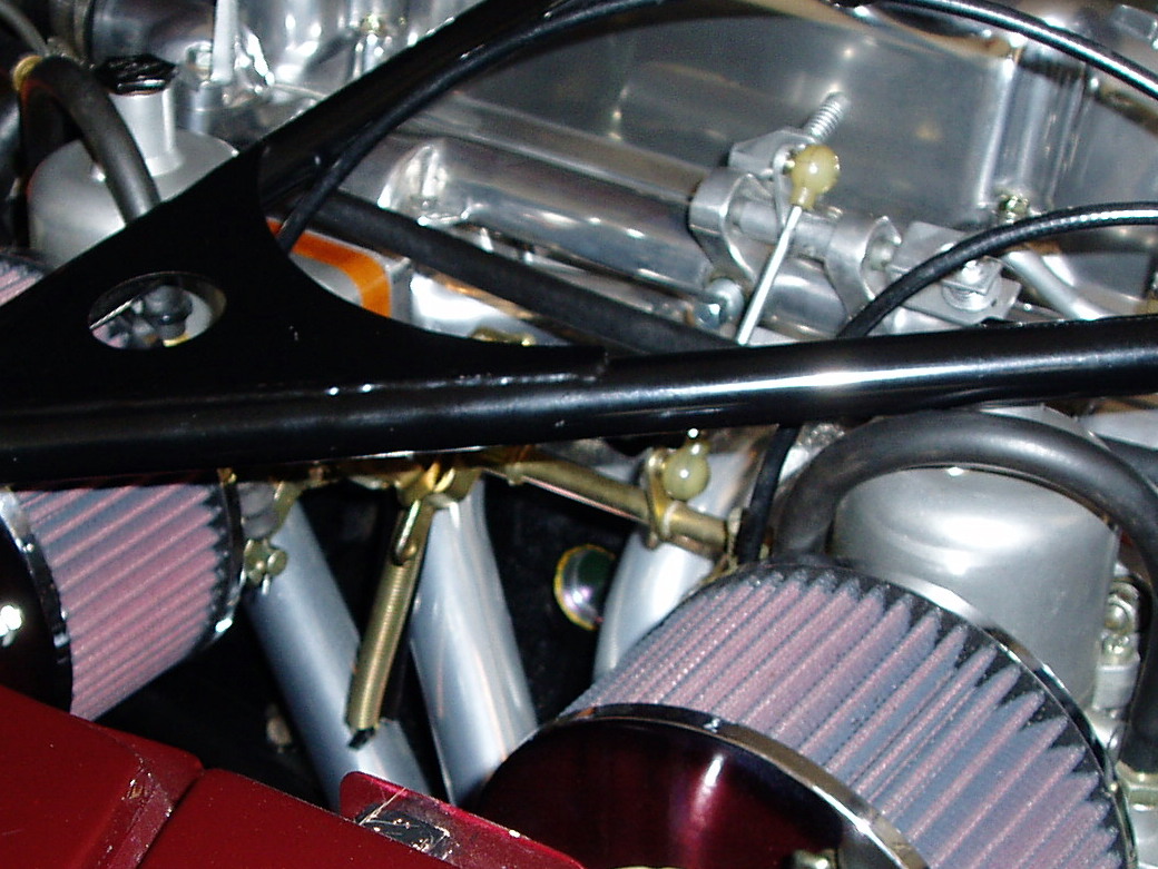

i fabbed up some 1/8" thick steel bar with tabs to mount to the SU's, to hold the throttle return springs down (pic)

Could make an interesting "booster", otherwise! Is that a 12GA? If so, I've got some 'full' brass ones around here somewhere if you want to dress it up.... they are really pretty when polished.....
Yes it is a 12 Gauge, but I doubt a brass shell would fit. I had to squeeze the end closed to get it started and then hammered it in place. Actually I had several colors to choose from, but I picked a Winchester AA shell because the red plastic matches the original color of the air cleaner.:cool:
doradox: Actually Indiana doesn't require a permit to carry around shotguns, and besides it is a hole plug remember?LOL

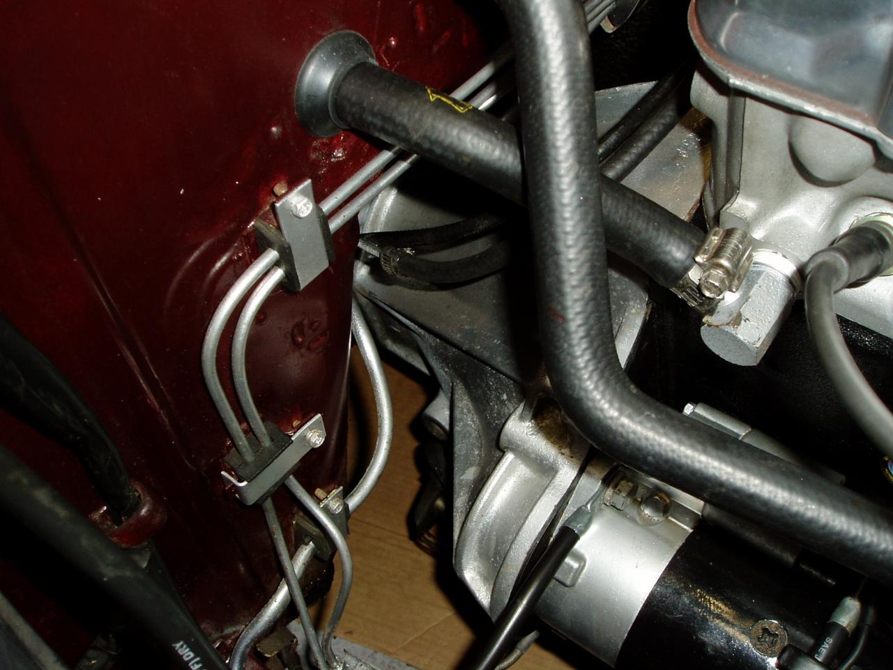

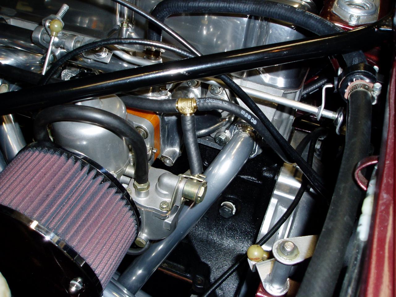

7277, your engine bay is now my benchmark. So clean! I see that you did away with the fuel rail and its return line. Any fuel pressure issues in terms of overflow? Also, the crankcase vent, can't see a filter on it. What did you do?

Ahh yes. i knew you'd ask about fuel overflow...LOL
i ran the 1/4" line from the fuel pump to carb #1 then straight on to #2. THEN, i ran a 3/16 line from carb #2 to the steel line (cut above trans bellhousing) that was normally the upper 'return' of the stock fuel rail.
NOW you'll notice on the stock fuel rail return end it gets crimped down to ~1/16 diameter. it is crimped like that so fuel from the pump doesn't just fly by the carbs leaving them starved and refilling your gas tank. i then cut that little 1/16" diameter end off and inserted it into the new 3/16" rubber return line, just prior to hose clamping it to the steel line above the bellhousing.....this way it STILL functions as intended, both as a (restricted) overflow line and a vapor lock relief..
pic #1 shows rear carb with 3/16" line to return over bellhousing. pic #2 shows where i cut the steel line that would have normally gone to the front of the engine bay. stuffed inside the rubber line at the hose clamp is the cut-off-crimped-1/16" end of the stock fuel rail overflow/vapor line.
