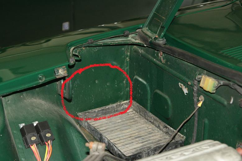

Can you draw the hole to be repaired on this pic? It may be easier to form in more than one piece and you could possibly do it yourself. The metal is stretched thinner in this area left of the battery tray because of the stamping process. When I removed the haphazard repair made by a previous owner mine looked like swiss cheese and what was left was paper thin.

Here's a photo of mine, I circled the area in question in red. On the Z I'm considering imagine where I circled that the whole area there is basically gone. I didn't think it was a structural issue, but wanted to be sure. My idea was just welding in a patch or getting something fabbed to match close.

Randy, I thought the damage would have been much lower than that. If that is the extent of it, you should not have a problem fabricating a single piece to repair this. You will probably find that the battery tray will need to be removed. All other spot welds on the piece being replaced must be seperated also. Plan it out and make a template out of stiff cardboard or bristol board from a craftshop, allowing you to test fit until perfect. It would be best to replace the metal all the way to the cowl, so to not have a seam to hide on that end. You should be able to form a piece that is virtually invisible after being welded in if planned out properly.
