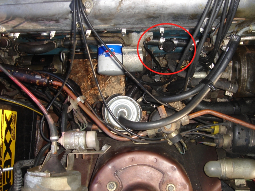

the only thing that makes it a little weird that i flushed the system back in the spring and i have been driving it since may a couple times a week so it could be a good possibility that the head gasket is blown or i have an internal leak due to the fluid that is coming out of the little k&n filter on the valve cover

If the old water pump broke it could have worn a hole in the timing cover which would explain the "Milky oil" in the crank case filter. As the bearings wear the shaft cam move causing the impellers to cut into the timing cover. You can pressurize the cooling system to about 15 to 20 lbs with a cooling system pressure tester and see if it will hold pressure, if not remove the valve cover, look down at the timing chain where the water pump would be. It sounds like a timing cover or blown head gasket.
