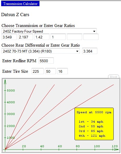

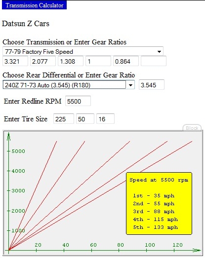

I should have been more clear. If you normalize the ratios using 3rd as a baseline, then you see that for the 4 speed 1st is 2.50 times 3rd, and 2nd is 1.55 times 3rd. For the early 5 speed, 1st is 2.54 times 3rd and 2nd is 1.59 times 3rd. In other words, on a relative basis, 1st, 2nd and 3rd gears are all the same (within a small tolerance) for those two transmissions.
If you were to swap the early 5 speed and leave the 3.36 diff, then 1st, 2nd, and 3rd would all provide slower acceleration than with the 4 speed. If you were to swap the diff to 3.54 at the same time, then 1st - 3rd would be almost the same as before. You would still have a relatively large change in ratio going from 2nd to 3rd. The later 5 speed has 3rd gear closer to 2nd which was the point Darrel and I were originally making.
Perhaps these 2 screen shots from the transmission calculator will make it more clear. Note that the max speed in the first 3 gears is nearly the same for both combinations.

I was comparing the type B 4 speed to the 77-79 5 speed strictly by gear ratio. Not the type A 3 piece 'monkey motion' early 4 speed. My point stands, the gear ratios in the trans are not the same. I won't bother posting the chart. It's already on the site somewhere. If you want to go on thinking they're the same that's up to you. It's really a rather moot point anyway.
