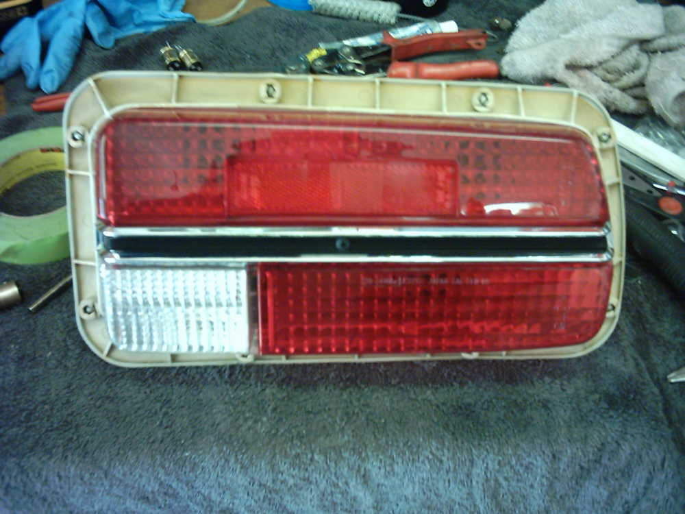

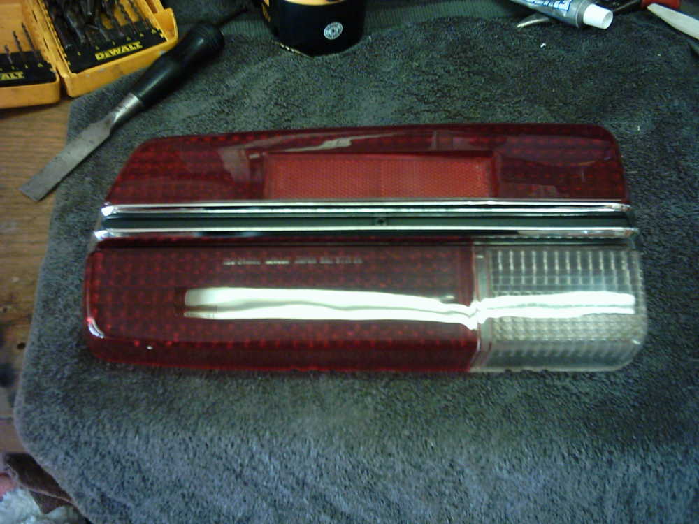

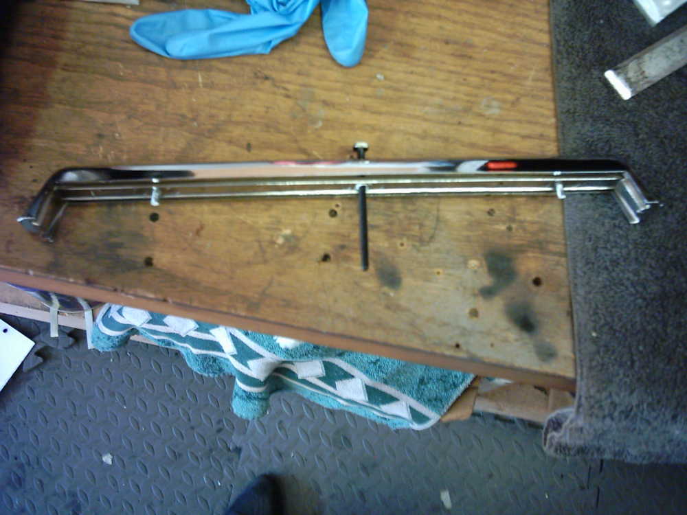

I would be interested as well but not for $75 a peice. Being as how I do the LED conversion on the 240Z taillights, I'm always looking for an alternative to the process I do. I run them under warm water and use "0000" Steel wool. It seems to clean them up very nice with NO scratching of the chrome. But that only goes as far as the condition of the chrome under the smoke and dirt damage.
If I knew exactly what was involved in the plating process, I'd buy the supplies and do everything myself and if I like the results, I'd offer it to everyone.
