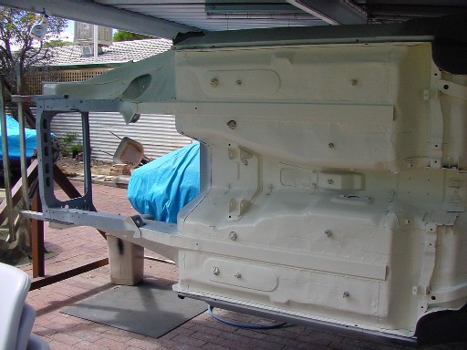

Enter soapbox mode: -
"It is only metal and metal can be repaired."
Only YOU can decide whether YOU want to do it/get it done and keep the car.
Even chassis rails are just folded sections of sheet.
Is it an economical proposition or should you cut your losses:rolleyes::rolleyes:
Post some pics. and open it up for discussion:ermm:
Both of the under floor chassis rails were replaced on this body, as well as sections of the floor pan.
As mentioned a PL510 is also ~36 years old minimum so Terry the Tinworm has had plenty of time to get established:(
