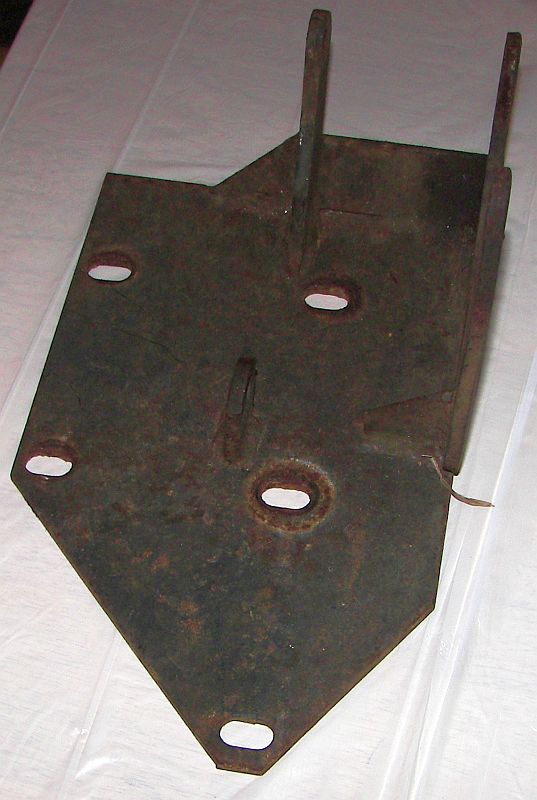

I'll see if I can dig out the adapter brackets from an older Sanden set up - and take a picture of them. Sanden used to have two models of their compressor a 5 series and a 7 series. I think the adapters were for the longer 7 series... but not certain.

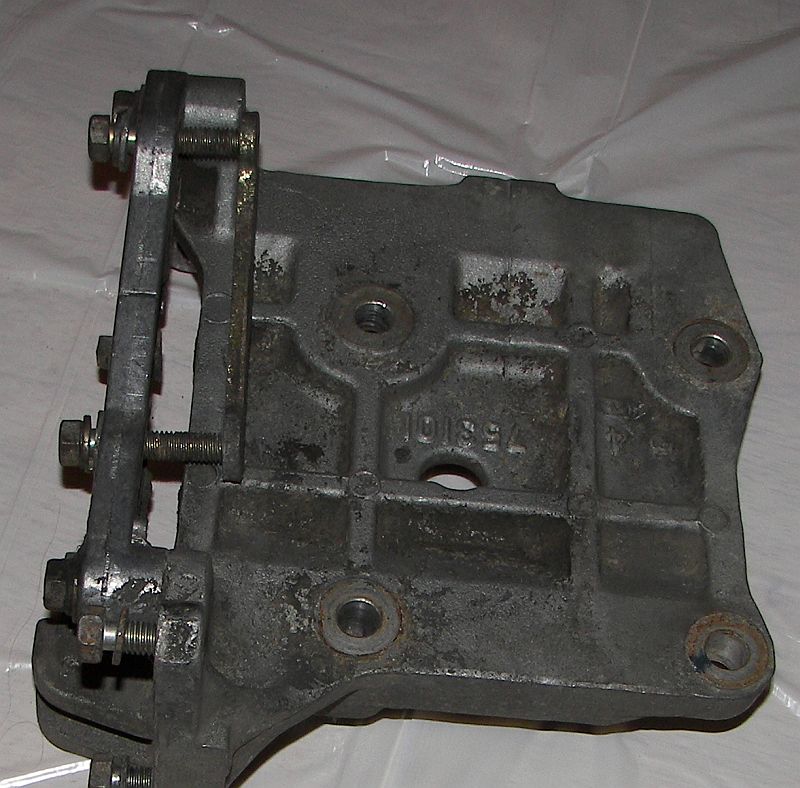

My bracket is slightly different, but I found that one from a 280ZX is lighter(cast AL.),made for other sanden compressors, and is a genuine Nissan part(11910-p8101)-though way too expensive from the dealer...perfect Pick and Pull part.
Will

I only asked because Sandens usually mount in such a way where they can pivot to adjust the belt and the Hitachis mount stationary and use an idler pulley for belt adjustment.
