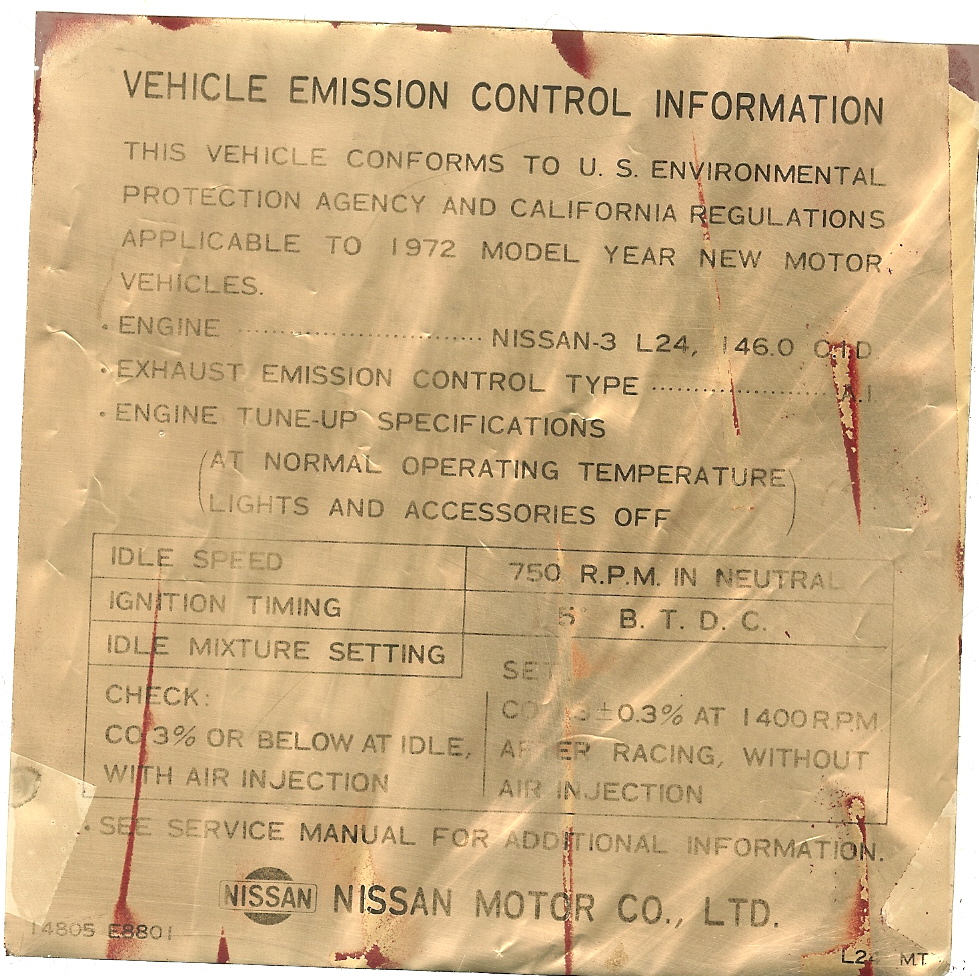

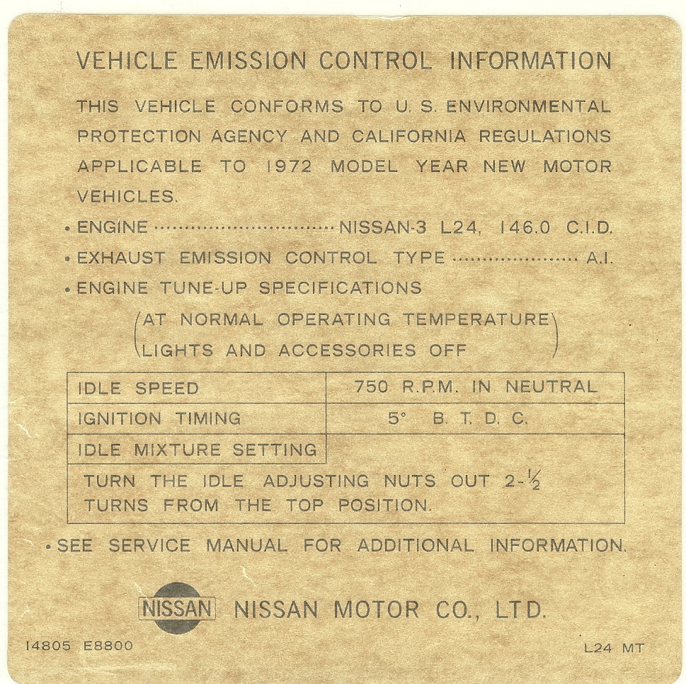

I have been searching for correct replacement decals for my Z, and thought I found one for the 1972 emissions decal from Zeddsaver...But, my part number on the original is 14805-e8801 while the one I purchased is e8800. There's obvious differences in text, see the attached pics below.

Anyone know around what date they changed the part number?

Since the 8801 has specs for an exhaust gas analyzer, there may be a Nissan TSB that gives the date of the change. Maybe some one who has a library of the bulletins could look that up for you?
I don't know if this will help or not. TS72-11 which was issued for all models on March 3, 1972. It deals with and includes a revised pre-pasted page to replace page EC-45 of "Service Manual, Emission Control System for 1972 Year Models, Revised Edition". This manual may contain dated information. I will look to see if this manual is among the ones I have, but I don't recall coming across a revised emissions manual. I have a technical training manual for 1972 Emissions, but thats about it I think. The only other TSB from 1972 dealing with Emissions that I found was TS72-90 dated August 25, 1972, which deals with tooling and test proceedures for two & three vane air pumps. I have not found anything specific to the emissions labels.

I'm not so much interested in the TSB itself. I'm trying to figure out if my purchased replacement is a faithful recreation of an earlier version from 1972, or just improvised. If there's some literature or p/n from a TSB or other update, then I'd feel a little better. Regardless, the 8800 is not correct for 5/72 and later, so maybe if someone could check their early 1972-late 1971 emission sticker I could (A) verify the accuracy of the e8800 sticker and (B) get an idea of what date range we're working in.
