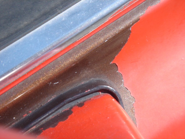

Here's an example of what may happen...
If you are going to do it, you may as well do it right.
It may be hard to see, but that red line on the stainless is indeed on the stainless. Very poor masking all around.

Zbane has already pointed out the biggest problem, hopefully you don't scratch any of your chrome or stainless in trying to sand that close to them, nor tear any of the rubber in applying or removing the masking tape.
