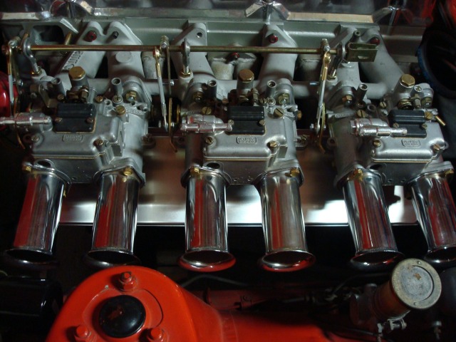

I just got in the under carb tray from http://www.zccjdm.com and I have to say this is top notch. This setup is with a Cannon manifold and the pan fit perfect with Dellortos, which have the under body accelerator pump arms. On top of that I have the Datsun comp header, which fits great but the last 4 tubes do extend out a bit far making it tough to get any kind of clearance from the bottom of the carbs. I"m not sure if the short manifold will work yet but I will try it out this weekend. Here's a pic.
Looks great on there. I've been considering doing the same thing to mine. Heat is most likely an issue with mine but like that site says, 44, 47, 50mm carbs. Mine are 40DCOE Webers. Are the carb bodies that much different from 40 to 44?
I think I'll have my custom metal guy take a look at it.
Nice, very nice.
Dave.
It looks great!
How do you assemble it? Is it clamped in between the head and the carbs?
What happens if heat is too important? Do you experience some lack of power?
I haven't experienced it yet. I have Weber 40 DCOE and coated headers.
It fit's 40's, that's what I have. It's held to the bottom mount studs on the carbs
