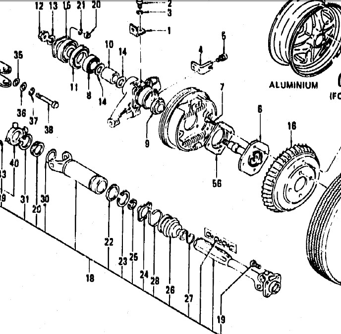

Your description doesn't make it clear to me which part is broke. Can you point it out on the attached picture? Which number?
#6 broke
and # 16 doesnt want to come off (brake drum)
What year Z is it? Is what you have in hand the companion flange with a portion of the stub Axel and nut attached? If this is the case you should be able to see some of the splined shaft sticking out of the Axel housing. right? If this is the case you are lucky you didn't loose the wheel. I am supposing that this is a early Z. Gary
Snapping a stub axle is not common at all, but not unheard of either. The part that's left is pressed into the wheel bearings. You'll need to get the drum off and use a slide hammer to remove it. The stub axle and both inner and out bearings will need to be replaced.
Brake drum. this can be a stubborn job in it's self. If you look at the brake drum there is a rubber plug in the face of it. Remove that plug. Can you revolve the brake drum, or is it tight and difficult to turn? If it is hard to turn likely the brake shoes are in contact with it and will need to be adjust away from it. This is what the little hole is for. The E-brake is attached to the adjuster that keeps the rear shoes adjusted. There is a lever that must be lifted off the adjustment wheel on the wheel cylinder. This is where you really need a manual so you can see how the lever is setting . This brake drum is sandwiched between the rim and the Axel flange. It is common that rust has formed between the drum and this flange causing them to become stuck together. If the drum can be rotated easily, then take a rubber mallet and strike the flat face of the drum at 12 o'clock then 6 o'clock , 9 then 3 . see if there is any movement , even slightly around the lug bolts and drum. What you are attempting to do is to dislodge the drum from the Axel flange. Repeat this mallet to drum trying to rock it loose. Do not use a hammer and do not hammer on the fins of the drum you will just brake them off. I use either P B Blaster or Kroil and spray it around the face of the Axel flange and lug bolts to help with the rust loosing. You can try and using a length of wood against the fins from the back side , I use a old hammer handle or like hard wood, and strike the wood with a hammer , again at the 12 ,6 , 9, 3 points. Take a deep breath and keep your frustrations at bay , because this can take time . Just keep repeating with the mallet and wood and hammer. The drum will come free . If the shoes are tight against the drum This MUST BE LOOSENED FIRST. Or the drum will not come off. In our case the Axel could come off with the drum. Hope this helps. Gary

If the stub axle breaks right under the stub axle retaining nut, the nut was most likely cross threaded when last installed. If a stub axle breaks at the base of the splines on the shaft, it was overloaded (drag strip type launches). If the wheel stud flange breaks off from the shaft then it failed from high cornering loads.
