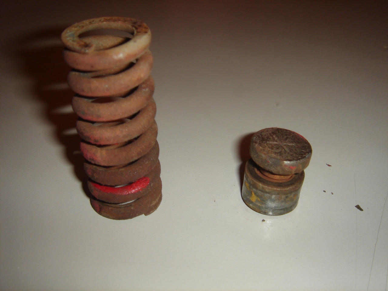

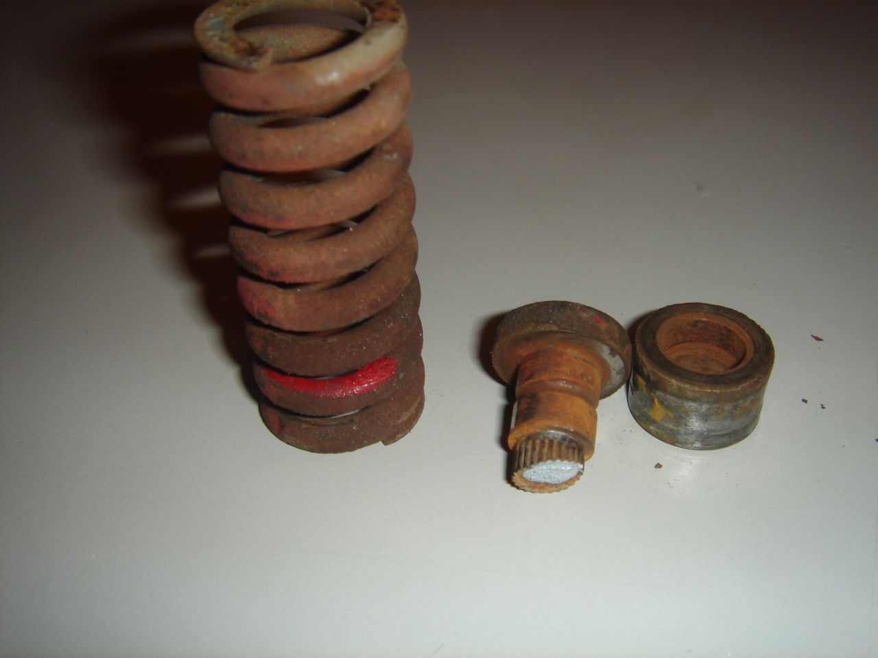

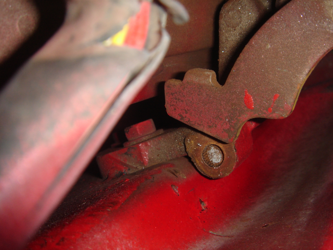

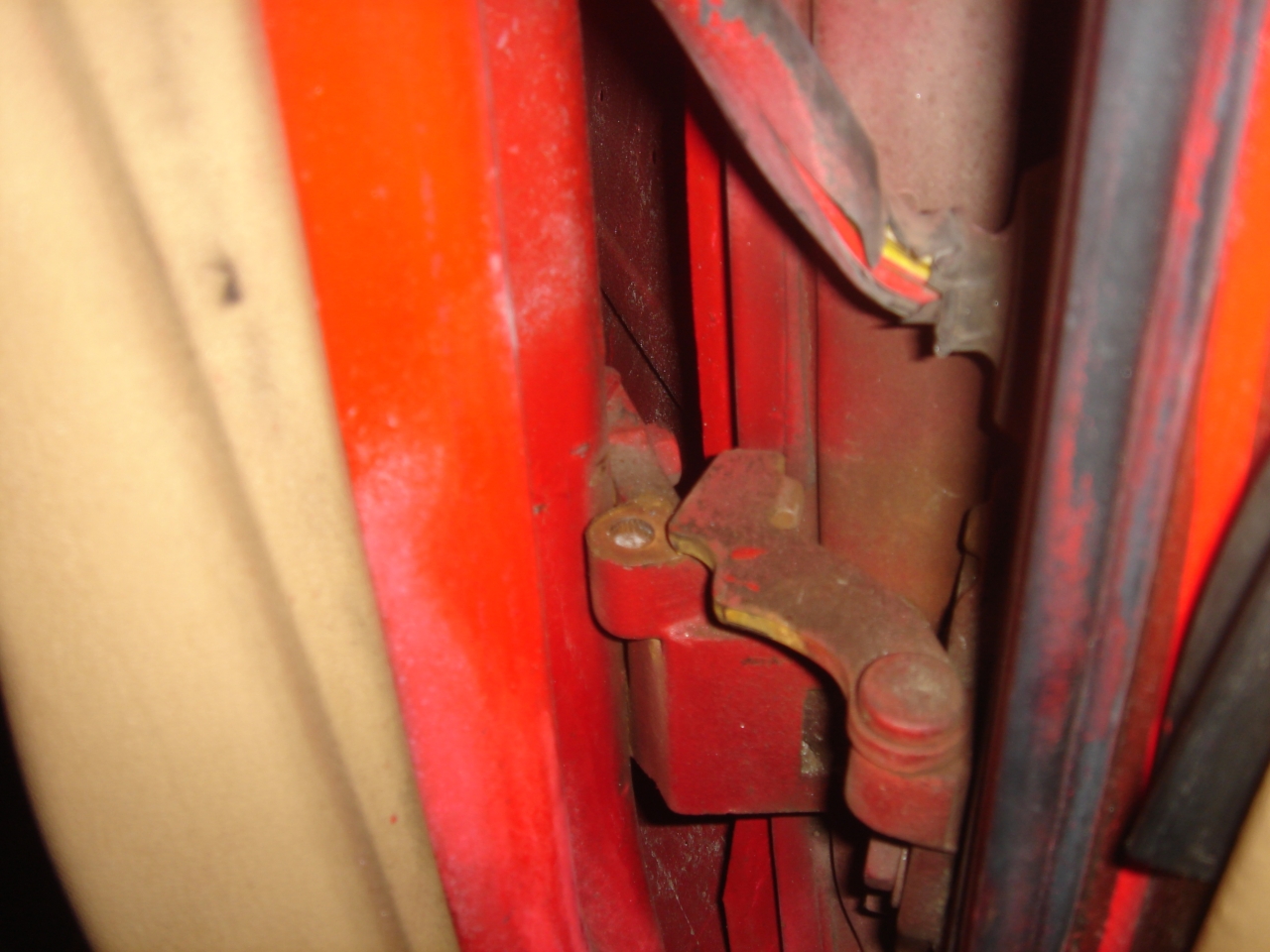

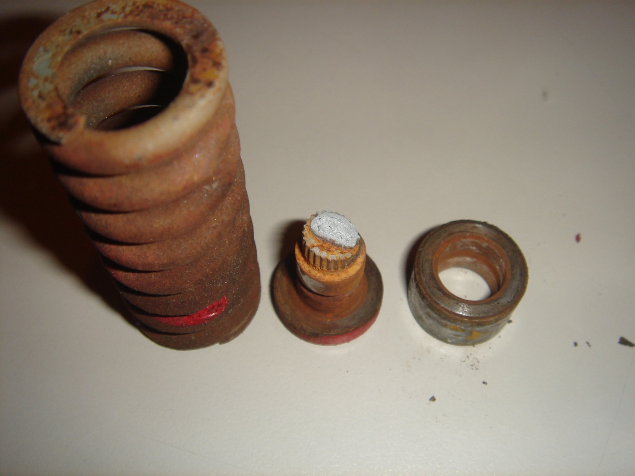

Over the past two years, I have found all sorts of little squeaks and rattles. One that was persistent in its re-occurance has been the door hinge return spring. I would clean it and lubricate it every 3 months or so.
So, I just got some lithium grease for my window tracks, and figured I would apply it to the door joints as well. Just as I open the door to do this, it binds and I hear a snap...
Are these posts replaceable, or do I need a new lower door hinge?

I had the same problem on my 280Z back when I got it. I replaced the hinge. The hinge I bought even came off a car that was the same color. It seemed like the easiest way to solve the problem. Even if you pressed out the old pin and replaced it, it would be tough to get the spring back in place.

I agree with you, but having tore two sets down, cleaned them up lubed and reassembled the operation difference is worth the effort. I know I would not put a used one in my car with out doing this work. Took me all of an hour to redo the set.
