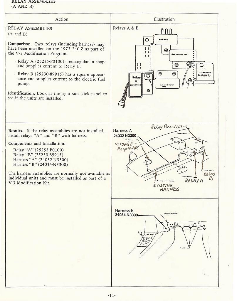

I am providing pics just to clear up continuing confusion on the 1973 240Z fuel-cut harness.
The harness has a terminal from the voltage regulator, a terminal from the starter solenoid. It also contains a FUSE for pump power(many people neglect this in their mods).
Here is the harness, it is actually 2 different harnesses
Fuel-CUT relay harness Part number
Fuel pump POWER harness part number
Here is the passenger relay bracket with the fuel cut relays removed. It also has the EGR relay and the stone-cold temp switch removed.
I sincerely hope this clears up the misnomers that continuously float around on the web.

There are a bank of relays on the passenger kick panel for the 1973 240Zs. There are 2 relays associated with the electric fuel pump.
Relay 1) cuts the fuel pump OFF once the alternator produces 12v(engine running).
Relay 2) cuts the fuel pump OFF when the starter is engaged(start pos on the key).
The operation of the electric fuel pump is only to PRIME or REPRIME(vapor lock) the fuel system. It will operate when you turn the key to the RUN position. The relays cause it to shut off once the car is running or the starter is engaged.

Nice info there Carl. Those are the harnesses.
It was my understanding that the add on kit was available to retrofit all the earlier models but was a factory installed piece on the 1973 models. I have never seen those harnesses in an earlier car. I have seen them in both the 1973s I have owned... and a few other 1973s.
Recheck the service procedures. I have checked the series relays operation and they are there to CUT OFF the electric fuel pump. There is no way you could test the operation of the electric fuel pump with the engine running... unless you disconnect the voltage regulator terminal.
