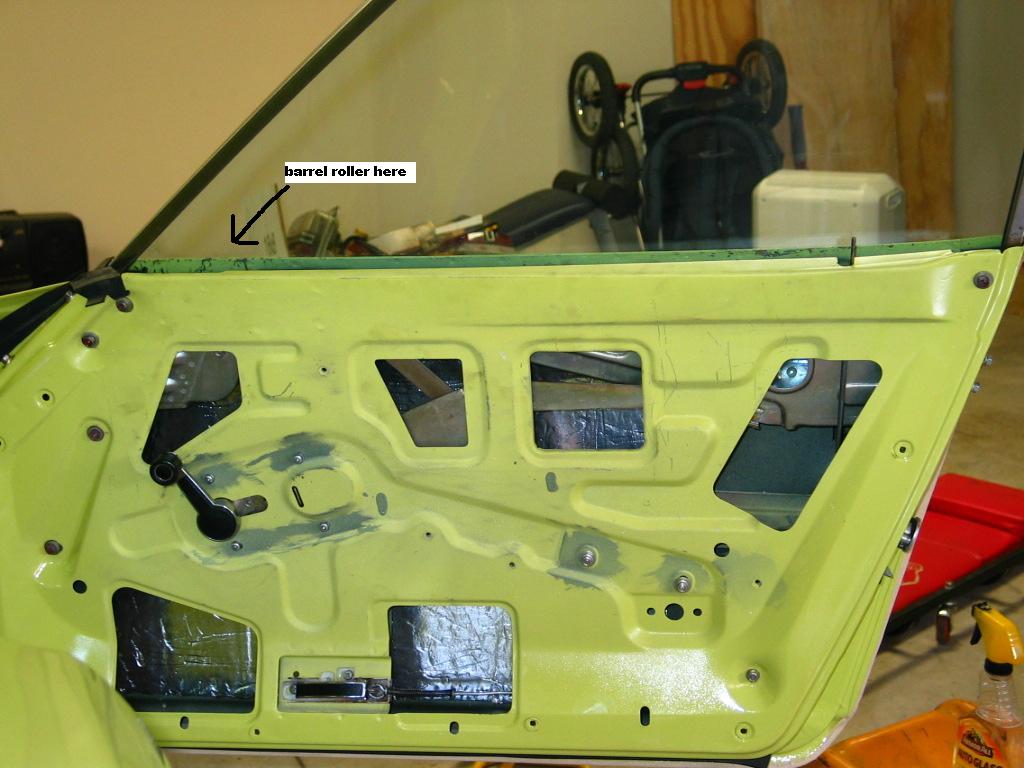

Where is the barrel roller? I have been out here for about an hour working with this window. The whole glass unit is what is moving back and forth. If you can visualize the door lock knob, it's like the whole piece is moving.
Any ideas???

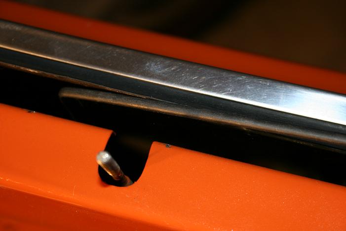

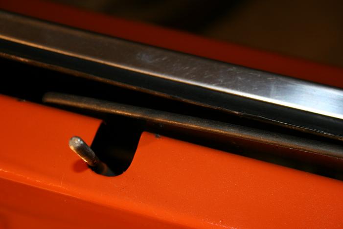

Here's a picture if it helps. One is of the window at rest where it lays against the body of the door, and the other is me pushing the glass outward. Also if I roll the window all the way down it slips back behind the door and you have to pry it back outward so it will roll up. Does this make any sense? I consulted Haynes and Wick with so results.
Thanks,
Randy
The barrel roller is located on the forward aspect of the window near where the window guide meets the door. You'll have to look sorta hard because the barrel part is under the outer door trim. If you pry off the trim you'll see the clip, but don't do that unless you have to. Or, you could reach (or look with a light) up from one of the holes in the door and feel for it. Pretty hard for them to fall off, but if the door trim has been removed for paint, and the roller, too, it's easy to see that someone might forget to replace it
If the pics show where the rattle is, I think you should check the window guide felt to see if it's (a) absent or (B) dry rotted. Maybe the rubber piece that cushions the base of the window unit has rotted off also (MSA part #30-2357), but others may have different ideas.
Remember, without your door panel there, the window will move in its slot. The fuzzy trim, along with the outer door trim, barrel roller and window guide channel felt keep it in place as it moves...
Good luck,
Steve
