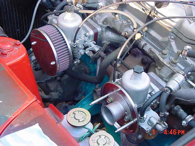

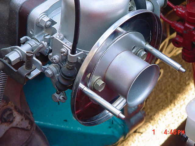

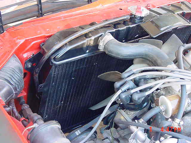

after everyone told me that i should go back and add the ram horns under my K&N filters, i whittled these out of an old filter box and installed them today. the car runs so much better, i have to admit. i thought they turned out neat. i also installed my new radiator today, which dropped the operating temps down considerably.
It's amazing what a little piece of tubing with a flare on it can do:classic:
Now all you need to do is fit some variable length trumpets which change the horn length for different rev ranges:rolleyes:
turned out nice, but how much clearance do you have from the air horn to the air cleaner top?
Looks like he's got a decent amount of clearance. I've got those K&N filters on my car, too, although I used TWM velocity stacks.
The metal cover to the air filter can't come any closer to the horn than the bottom of the threads on that support rod. He looks like he might even have more clearance than I do......
i didn't put a tape measure to it, but it looked like an inch or so to me. if you look at the right stud that holds the top filter plate from the end of the threads to the tip of the air horn there is at least an inch.
Horns look really neat.
How hot were you running? Dropping operating temps below optimal will hamper performance...

the temp gauge now sits about in the middle or slightly past right on the m, i guess we are good there.
