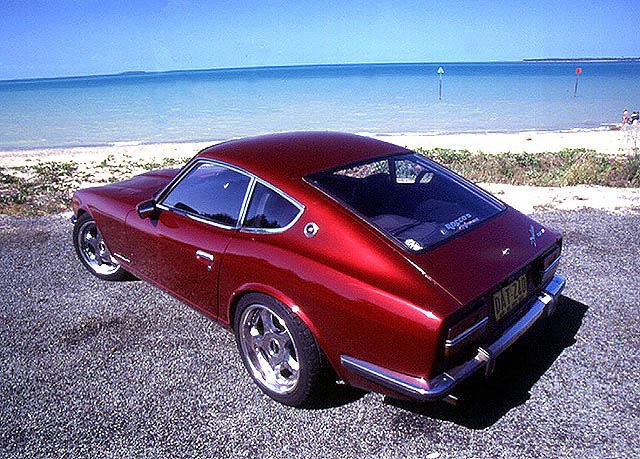

After a bit of advice, I've tracked down a fully restored and modified 240z, it has appeared in magazines over here in oz, and the owner will be selling in about a month... he's asking about $18,000 aud (about half in us dollars $9,000)... the following is a list of his modifcations (written by the owner) and a picture, just wondering if any of you have used a button clutch, if so, what are they like to drive?...
"...I bought the car three years ago already restored for $12,000. The engine
and gearbox had problems, however, so I decided to do an engine conversion.
I had the 1JZ-GTE twin turbo engine fitted by Rocco's Performance. It has
polished pipework, a large front-mount intercooler, Haltech E6K computer and
3-inch mandrel-bent exhaust system. It makes around 200kW at the wheels with
13.5psi boost and has run a 12.5 second pass on street tyres.
The entire driveline has been replaced too. It has a button clutch, Supra
5-speed, custom tailshaft, 3.9:1 LSD (R200) and custom-made driveshafts with
DR30 CV joints (these cost $1800). The brakes were another part of the
project, now 330mm vented front and 310mm solid rear discs, with HSV
2-piston calipers on the front.
The wheels are 17x7.5 and 17x8 Evolution Stich three-piece alloys, with the
guards lipped to fit the rear tyres (235/40ZR17). The suspension is
Whiteline springs, KYB shocks, Lovells swaybars etc, with modified rear arms
to allow toe adjustment. Despite all this the body is completely standard,
in metallic red. The interior has a fresh dashboard and trim, standard seats
retrimmed in leather and velour, custom console, custom stereo installation
and so on. It is virtually a show car, but set up to be driven daily if
needed. It also has 12 months rego, all receipts for my work and full
engineering certification..."

Don't buy the car...by the land and build a house on it...what a view.
Great colour isn't it. The clutch will most probably be a high performance tri blobby dowhacky. Hell I can't remember the correct name for it. Basically you get more performance out of a clutch with this design. Someone else will tell you why no doubt if you really need to know. The pedal would be a little harder to press I woudl think but I'm only guessing.
It is quite obvious that with that engine in there...it would burn out a standard clutch in no time. What rear wheel HP has it got?
Check to see if those 17's rub on the guards. It will be very close.

Only thing I see wrong with the photo is that I'm not in it!!!:cry: :mad:
Let's see, me, my dog, and a beautiful female, oh well, it's nice to dream huh?:cross-eye
You shouldn't have too much trouble with it with a hydraulic clutch. It would be a lot stiffer if you had a mechanical linkage trying overcome the heavy springs used in the pressure plate with a puck type plate. Your leg would surely get a work out.
Gotta love that color!!
I'd be afraid of taking it out. I would recommend parking that beauty in the living room and getting rid of the furniture. NNNIIICCCEEE!!!:classic:
All i can add is what a beauty.
If you do end up buying her congratulations and please add loads of pics in the members gallery, also let us know what colour that car is.
Good Luck.
I like that with the candyapple paint & no side marker lamps. I think it helps the flow of the body.:love:
I filled mine awhile back. Now very happy I did after seeing one done & painted.:love:
That for 9k. Take it!!! :love:
