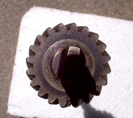

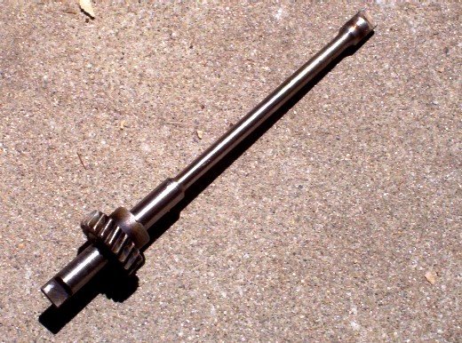

I found this in my trunk.
I was wondering exactly what it is.
It has 20 teeth on it and I'm assuming it was switched out for something better or stock as parts of the car was already rebuilt or "refurbised" so to speak when I
bought my 1977 280Z 4 speed.

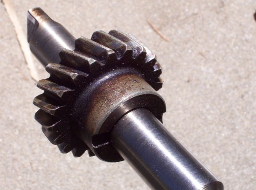

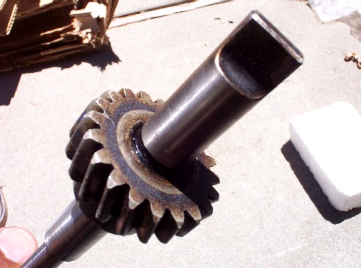

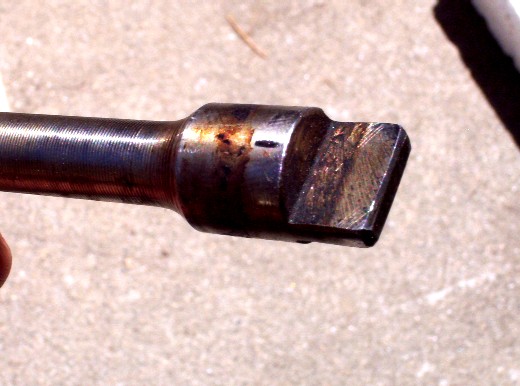

the gear is rotated by a helical gear on the crankshaft. that rotates the shaft. the locator on the bottom (near the gear) is an impeller for the oil pump, and the other side rotates the dizzy
