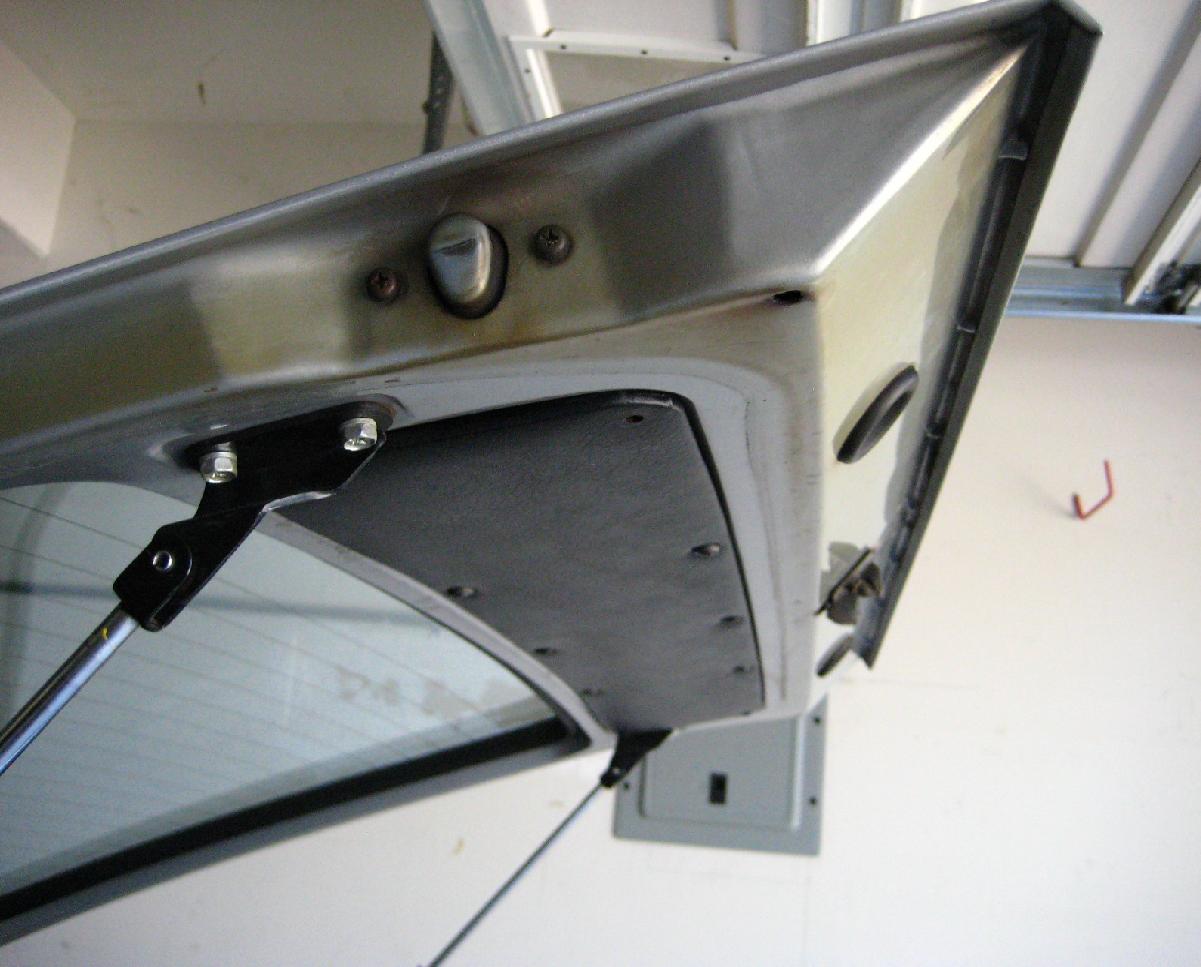

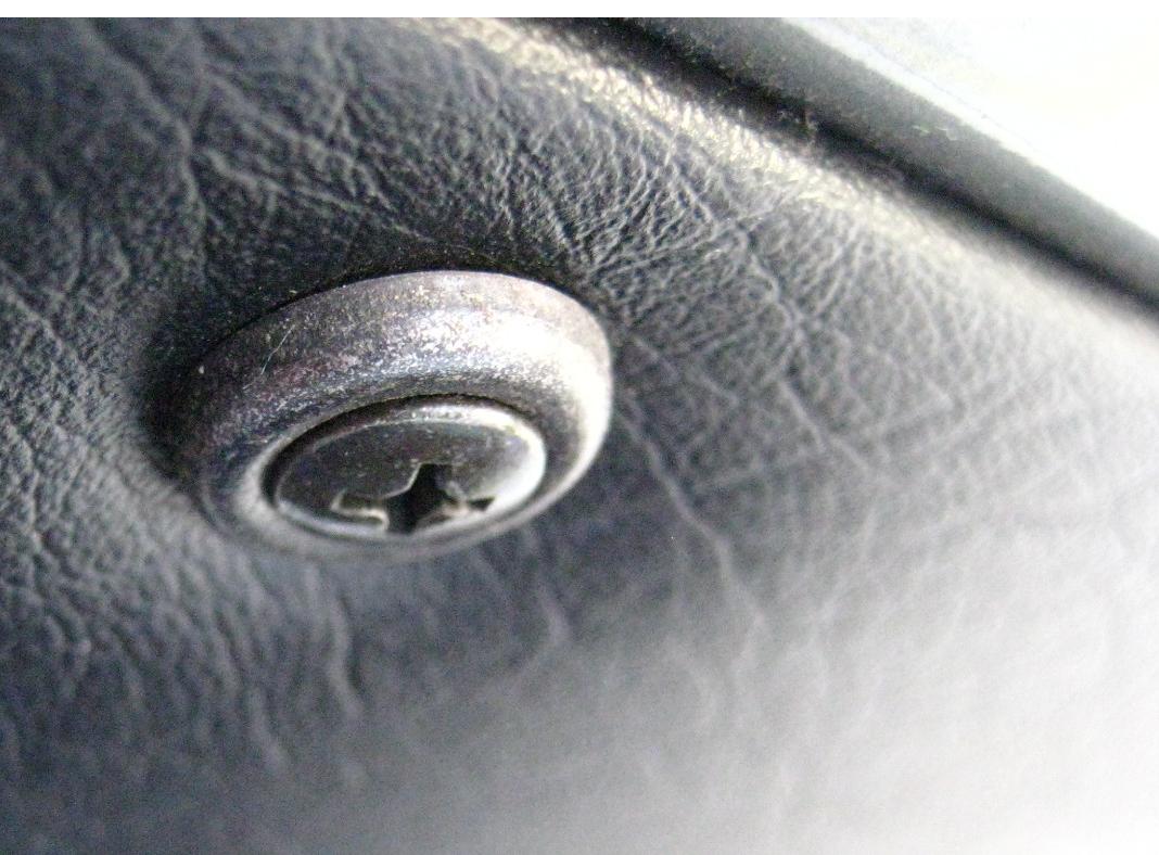

im just doing a little refurbishing on my z and noticed that the rectangular panel under the hatch is attached by 4 screws and 4 black rivet clips, but none of the rivets have the little pin inside of them. i tried inserting the pins but they simply wont go all the way through. even if i try forcing the pin in the rivet, the pin will bend or break before it makes it half way through the rivet hole. does anyone know, or could anyone check to see if rivets or screws were originally used to attach the panel to the hatch? these pictures might give a better idea of what im talking about

No rivets there. Ten screws like the one shown in your center picture are what holds that panel on in my 78. That being the case, the holes are too small to use the rivets and that's the source of your discomfiture. Tighten the screws lightly or the washers will cut into the fabric.
I used the same ones as sblake for all my interior . I used the polished stainless washers and stainless screws. I used the yellow size molly inserts in the holes and the screws spread the plastic inserts and provide the screws a purchase. Mine have held in place now for over 3 years. Not original I know but my color isn't either and my 240 has ZX engine . Gary

Self tapping screws are what I used. Since the interior is black, I used polished screws with large polished washers. I was going for the aircraft, industrial look.
