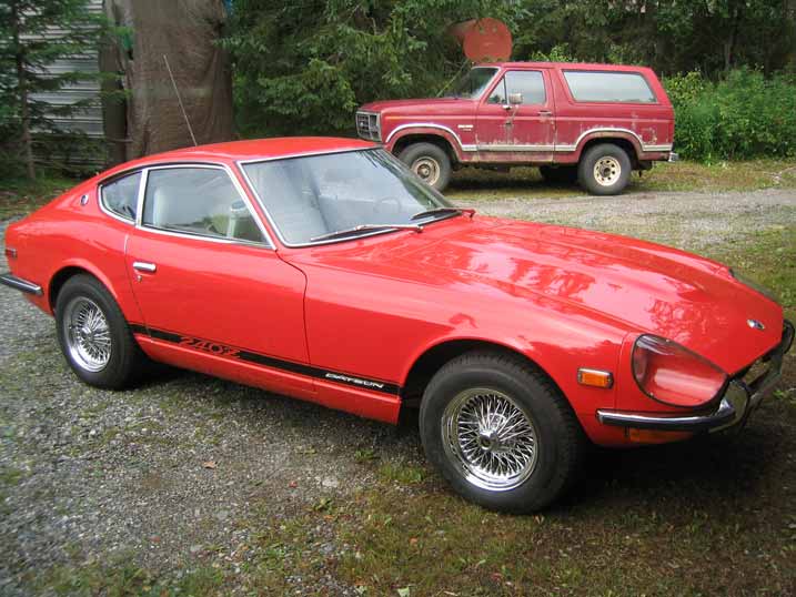

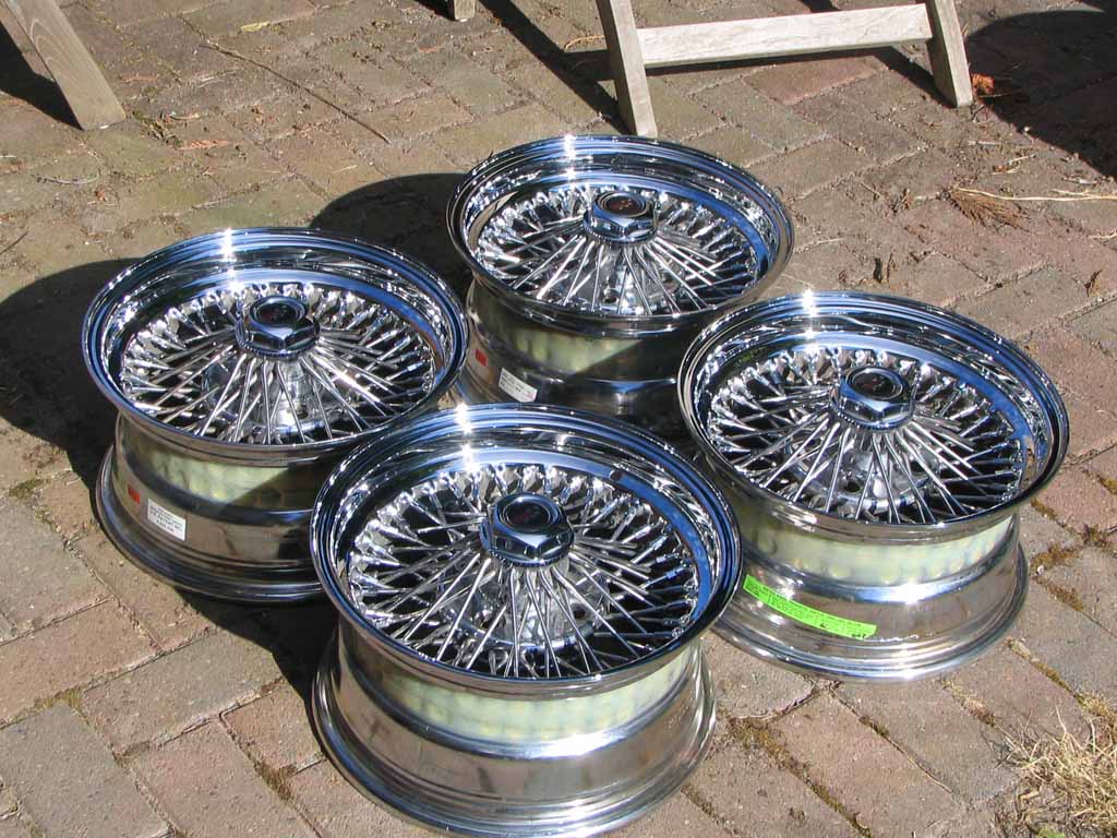

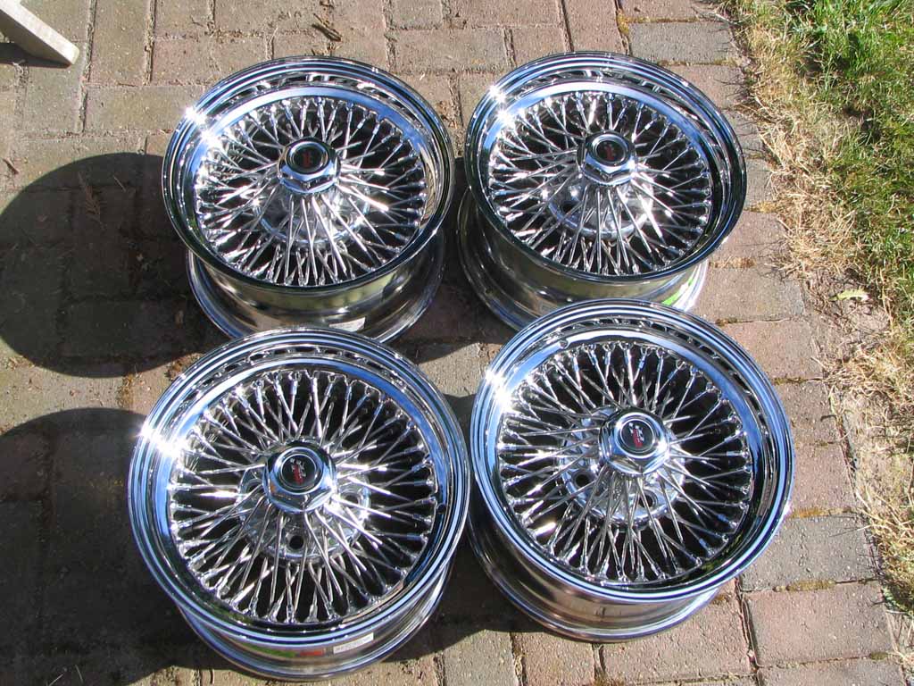

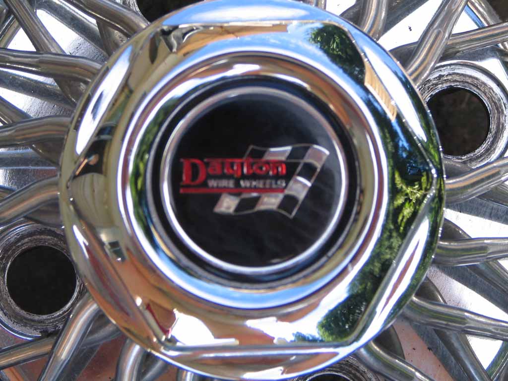

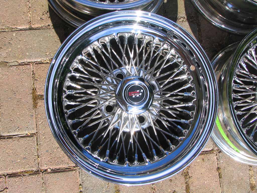

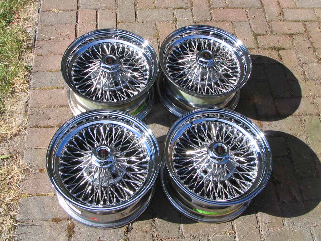

I have a set of 14" Dayton wire wheels that came with my 1972 when I bought it. They hardly have any miles on them (the car only has 37,000). I have the paperwork and invoice for them around here somewhere. The original owner bought them new from Victoria British in the early 1990's I think for around $1200 for the set. It looks like your link shows them to be over $500 each now. I have the lug nuts for them as well. I am attaching some pictures of them I took last summer and one from when they were still mounted on the car. PM me if you are interested.
-Mike
