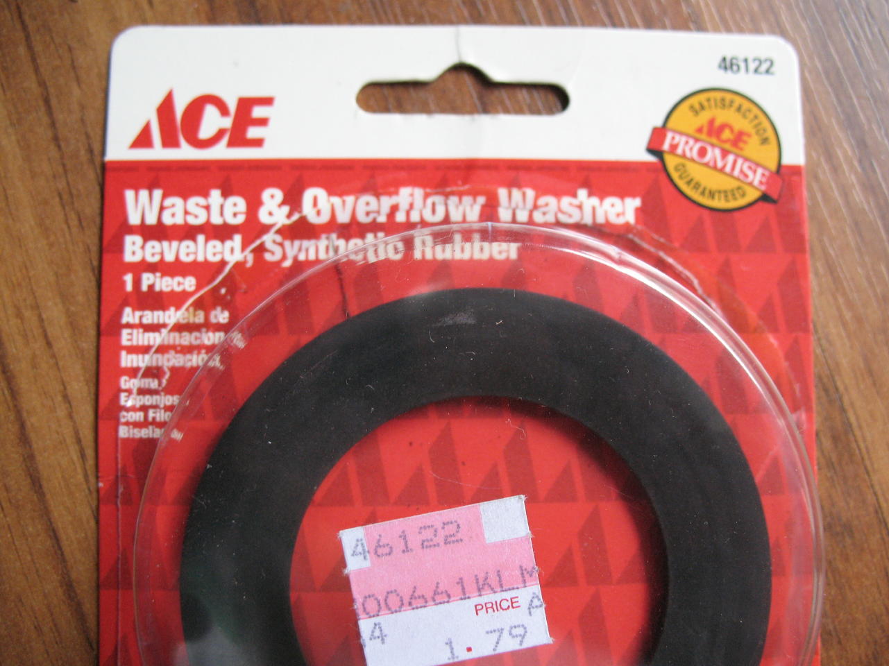

Posted May 6, 200718 yr comment_208613 Ok, please tell me if I am nuts here, I can't see why this won't work... So as some of you know, I have been having issues with fuel down the side of the car on a hard left turn. I called around for a cap, and nothing was avail until next week. So, as I was in Ace Hardware to grab some c-clips, my curiousity got the better of me and I wandered over to the plumbing isle. There I found a waste and overflow washer that is a great replacement for the rubber in the stock cap... It's made of synthetic rubber, it's a bit thicker and provides a better seal than the old one. It fits almost too tight but after a few twists, it adapted down a bit and now while tight, is not impossible to put on. I just took out the old rubber and worked this where it was. The best news is, it was $1.79 verses the cost of a Dealer Replacement cap! I am going to attach pics, but that part number from Ace is 46122, "Waste Overflow washer". Lemme know what you think. And yes, I will deny that there are toilet parts on my Z! Link to comment https://www.classiczcars.com/forums/topic/24242-improving-existing-fuel-cap-under-2/ Share on other sites More sharing options...

May 10, 200717 yr Author comment_209108 I planned on posting the update this morning.So here I am...So far so good!! No signs of deterioration or discoloration, it's been on the car for a few days now and it's a bit of a tight fit, but not impossible to put on. You may have to bend the "tabs" on the cap out slightly, but I have a great seal and no more fuel down the side upon the hard left.I am pretty sure that EScanlon nailed it with the sythetic rubber evaluation.So all in all, not bad for $1.79.Hope this helps some!~Brian Link to comment https://www.classiczcars.com/forums/topic/24242-improving-existing-fuel-cap-under-2/#findComment-209108 Share on other sites More sharing options...
