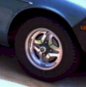

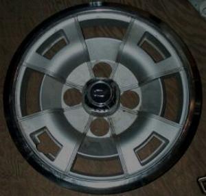

May 1, 200718 yr comment_207908 Only these hubcaps on stock wheels and the rims shown were put on 78 280Z's from the factory. Link to comment https://www.classiczcars.com/forums/topic/24171-factory-wheel-options-on-78/#findComment-207908 Share on other sites More sharing options...
May 1, 200718 yr comment_207909 Only these hubcaps on stock wheels and the rims shown were put on 78 280Z's from the factory.And both were 14". No 15" choices on the 280Z. Link to comment https://www.classiczcars.com/forums/topic/24171-factory-wheel-options-on-78/#findComment-207909 Share on other sites More sharing options...

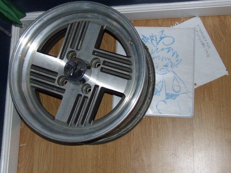

May 1, 200718 yr comment_207919 the only 15" rim for 280zx i can think of was the swastica style but am fairly sure that was on the later turbo models.here's a pic. Link to comment https://www.classiczcars.com/forums/topic/24171-factory-wheel-options-on-78/#findComment-207919 Share on other sites More sharing options...

May 7, 200717 yr comment_208754 Or could be the "honeycomb" turbo wheels from an 81 ZX. I think they only had a gold trim. Link to comment https://www.classiczcars.com/forums/topic/24171-factory-wheel-options-on-78/#findComment-208754 Share on other sites More sharing options...
