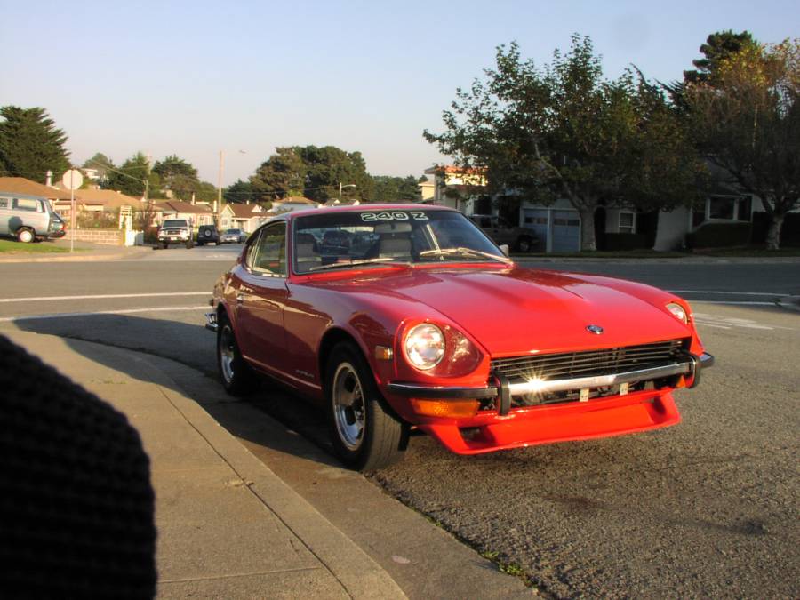

Posted April 27, 200718 yr comment_207381 hi guys.i've done the wheel option to death and i thank you all.now for the front spoiler dilema.they are alot cool z's with a more modern front spoiler or airdam's (to you u.s dude's) but is there anything out there a bit more retro and period.i know the first thing that spring's to mind is the bre spook style spoiler which i really like.however is there difference's with supplier quality because some don't look as great as others in the pics? look at the difference?is it color,angle or make?(no offence to owner of nice red zed!) Link to comment https://www.classiczcars.com/forums/topic/24111-front-spoiler-modern-or-retro/ Share on other sites More sharing options...
April 27, 200718 yr comment_207400 I'm planning on getting a spook later this summer. I've looked into this as well, and have come to the conclusion that while there are more than a couple small shops cranking out this style, I will buy mine from Classic Datsun Motorsport. They have the original BRE mould, and the consensus is that theirs are a bit better fit than most.That's not to say that there aren't others that fit OK too. Several people have indicated that the ones from MSA aren't bad either, which I believe are made by Showcars Bodyparts. The MSA spooks are on sale right now for $100.Last part of the equasion is the condition of the valance you are attaching it to. If that's not straight, the spook is going to warp and twist when it's attached. That may be the issue with the red car pictured above, might not be the fault of the spoiler. Link to comment https://www.classiczcars.com/forums/topic/24111-front-spoiler-modern-or-retro/#findComment-207400 Share on other sites More sharing options...
