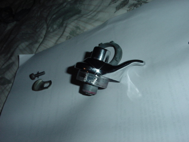

I had similar problems, I just took my door apart to assess my problems. I took the entire door lock and assemble out, cleaned up, greased up some parts and now she is working great although my hands and arms are all torn up, from reaching around inside the door. While I had it apart I drove to Classic Datsun and got me a new door handle(mine was a little pitted). It was fun job and I can glad I did it, now I just need some new dovetails and everything will be like new. Les did not have dovetails in stock.
