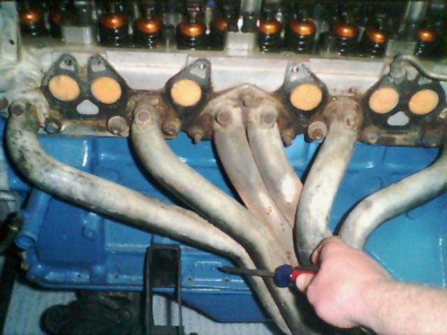

The way to identify the block is to look on the driver side of the engine,
to the right of the motor mount. That's where they cast the block number
Photo from another thread:
Funny, I've never noticed that before? I'll have to take a look, although I've got a feeling that my extractors are a little more in the way.... Which block do you think is the best from a performance point of view?
R.
From what I've read the #F54 (280ZX Turbo) block is the strongest because of it's simesed cylinders.
But if your building a Naturally Asperated motor you'll want to replace the dished turbo pistons with flat-tops.
I believe those turbo blocks have extra cooling holes as well
