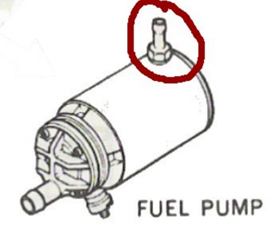

The fact that it fires up immedaitely makes me think that the cold start valve/thermotime switch are okay. Sound more like it's not retaining enough fuel pressure and having to fill up the fuel rail before it will stay running. This is usually caused by a bad check valve or leaking injectors,
Injectors are new. On the firing up, it usually turns over for 3 - 4 seconds before it cranks.
Take a look at the check valve and make sure it's not letting the fuel flow back.
