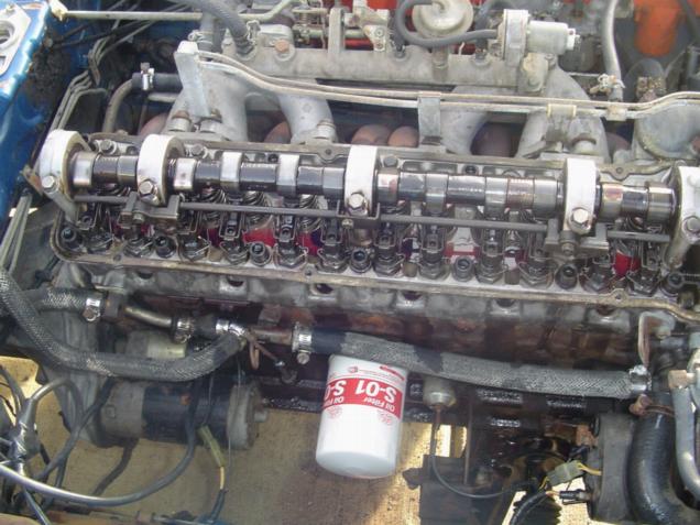

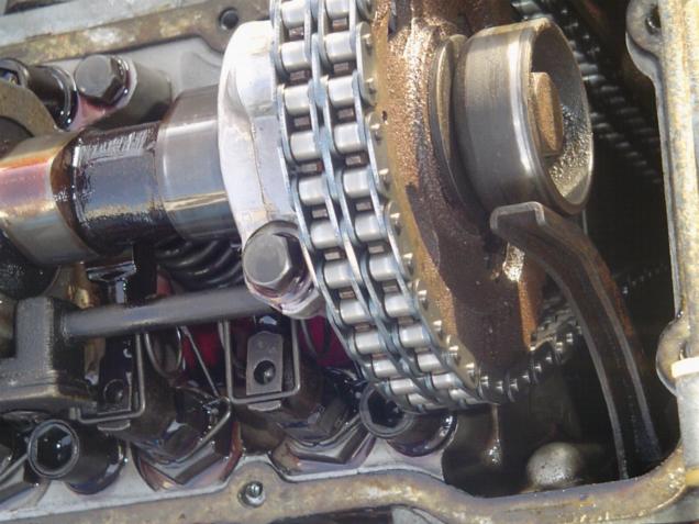

I am trying to wake the sleeping beast and I am following the directions in the same named thread about trying to coldstart an engine that has sat. I didn't use ATF fluid but I did use Mystery Oil and was told I should get the same results. I am ataching pictures of the engine w/o the cover to see if any one notices anything out of place. I can not get the pulley to budge.
I will try it again this morning to see if any of that oil helped lossen up the motor. For clarification purposes, the 27mm bolt on the pulley that I am supposed to be trying to turn would be the bolt that lays directly behind the bottom of the fan blades and has a belt around it. Correct?:stupid:
If anything looks out of the ordinary with these pics, or if you would like a more specific pic please let me know and I will post them.

How long has the engine sat? There is only one 27 mm bolt on the front of the engine so you have got to have the correct one. Did you make sure that the car was out of gear? Everything looks ok in your pictures.
