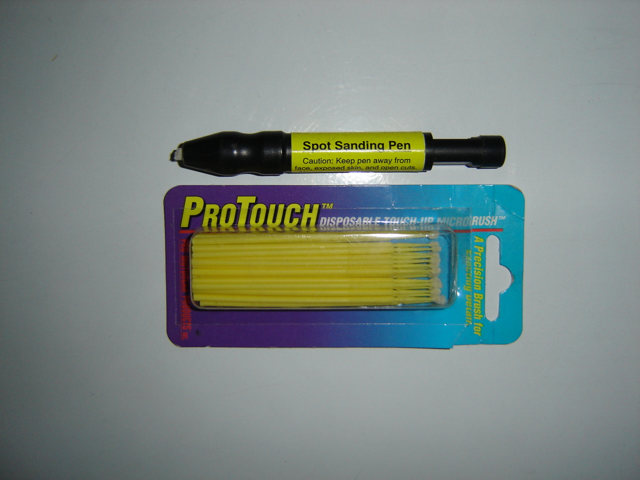

Dan,
I think degreasing is one of two important steps in reworking your emblems. The other step is being able to scuff the chrome surface so the paint has something to grab onto.
In addition to a degreaser, here are the tools I used to prep small parts and these can be economically purchased from an Auto Paint Supplier.
FWIW, I've painted a number of parts here in Phoenix and haven't had any issues with peeling paint. I painted a chromed aluminum bumper from a BMW, E-30 years ago. All I did was sand the chrome with 220 wet/dry paper, cleaned and then painted it. No primer, no prep solution, just painted it. I had the car for four years after I painted the bumper and it looked great right up to the day I sold the car. Never had any cracks due to heat expansion either.
Good luck with your emblems.
Bruce
