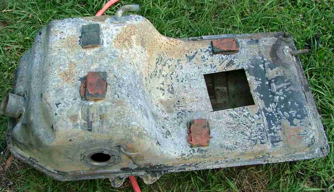

I'm finishing mine up. Did eloctolysis for a couple days using wahing soda and a little ospho. This stripped the paint and residual gas out of it. (Someone had coated the inside before) Cut an access hole in the top, sandblasted, and phosphoric acid treated it. I'll sandblast again and apply metal prep before applying RedKote. Redkote is a great gas tank liner and is used by my local radiator shop and others. It is something to look into at $31/qt. After having read all of the smear/neg advertising between Hirsh and POR I decided to stick with Redkote. The local radiator shop guy showed me the insides of a few tanks he was doing which had been coated by other processes. This greatly influenced me as well. It can be removed by soaking in MEK if one should need to remove and reapply. It also seal holes up to 1/16".

Here is what my research has found regarding creating conditions for safely work on a gas tank. (Welding, cutting, anything involving sparks or heat etc...)
Since a mistake with a gas tank is a one time thing I'll list methods which have worked for some but should NOT be relied upon. Ususally the work being done on the tank was welding or sweating. The following methods though somewhat sound have FAILED at one time or another and should NOT be used...
Filling tank with water
Assuming tank that has set dry for a year is safe(Can't smell fumes)
Purging tank with exhaust pipe. CO supposedly negates combustion.
Purging tank with inert gas such as argon. (Similar to above)
Washing tank with water
Methods that work and what should be used...
Take tank to radiator shop for boiling and any welding/sweating req.
If you are doing it yourself...
Drain all fuel and place in approved container.
Use strong degreaser to thoroughly clean the tank. Clean tank until no residue is showing in waste water.
A good follow up for the degreaser treatment is electrolysis as this will liberate a lot of crud that the degreaser might have missed. Electrolysis has dangers of it's own so I will make a page for the electrolysis and place in a later post. It's cool and it really works well. One shouldn't rely on it to remove all rust inside a tank despite using internal electrodes.
Cut access hole in top of tank and sandblast. Stop occasionally and use a light and mirror to see what you've missed. When you have removed 90% of rust then drain sand and apply ospho to inside of tank. Let ospho set up for 24 hours and sandblast to remove all traces of it.
Conduct any sweating or welding on the tank now that it is taken down to bare metal inside and out. Create and weld in patch for access hole.
Apply metal prep such as Hirsh's tank etch to inside of tank. Follow product instructions.
Apply tank sealer per instructions. See my original post for opinions/reasons for using RedKote tank sealer.
Some people use muriatic acid to nix their tank rust but this is very destructive as it eats metal. If the chemical reaction isn't neutralized it could continue to eat things or rust out the tank. The way to be absolutely sure that the rust is gone is outlined above. Make sure that you focus on the seams and any areas which harbor rust when sandblasting. Ospho gets the rest but needs for there to be as little rust as possible for maximum effectiveness.

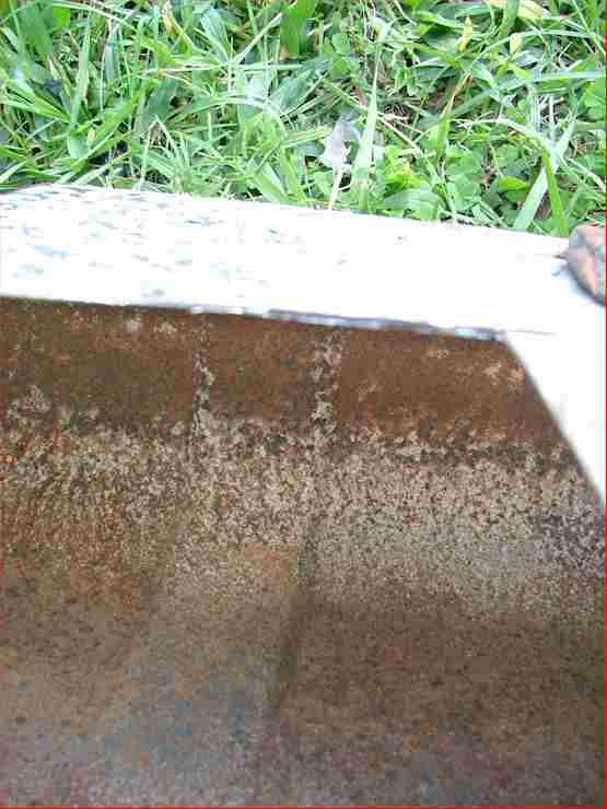

Attachments are post tank cleaning/electrolysis. Single "L" shaped electrode was used inside tank. Note how more rust was removed in areas closer to the electrode.
