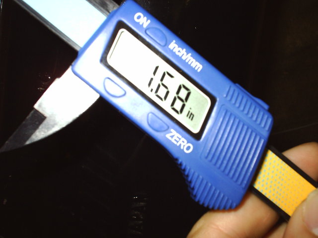

I still have that system. I just measured the outside diameter of the pipe just before the muffler and get a whopping 1 5/8". Obviously the original specs would be in metric so, perhaps 40mm?
OK, that helps. So when I get my new exhaust built with 2 1/4", even if I don't get mandrel bent it looks like I'll still be at least equal to stock.

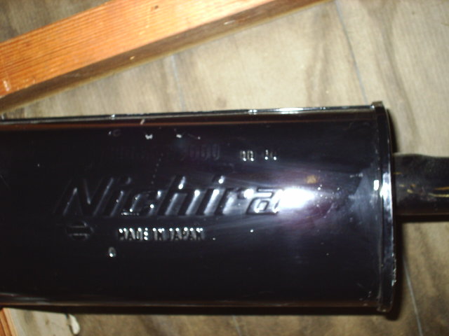

I have a new NOS Nissan exhaust for a 280Z and I just measured it:
1.75"

The outside diameter of mine is 1.75 inches as well with old fashioned bends no mandrel used on this one. This answers some of the clearance issues the guys are having getting the larger pipe under these cars.
