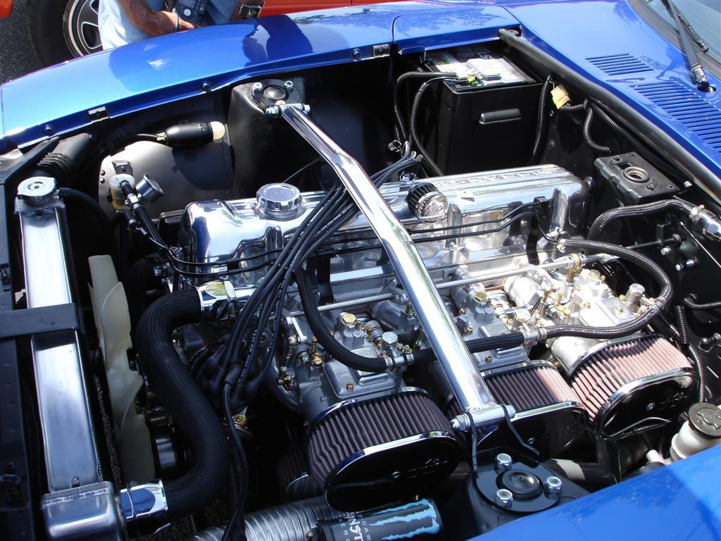

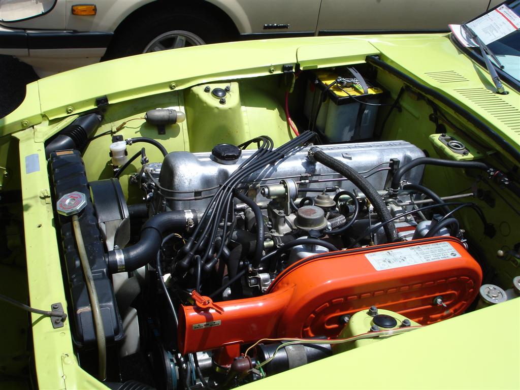

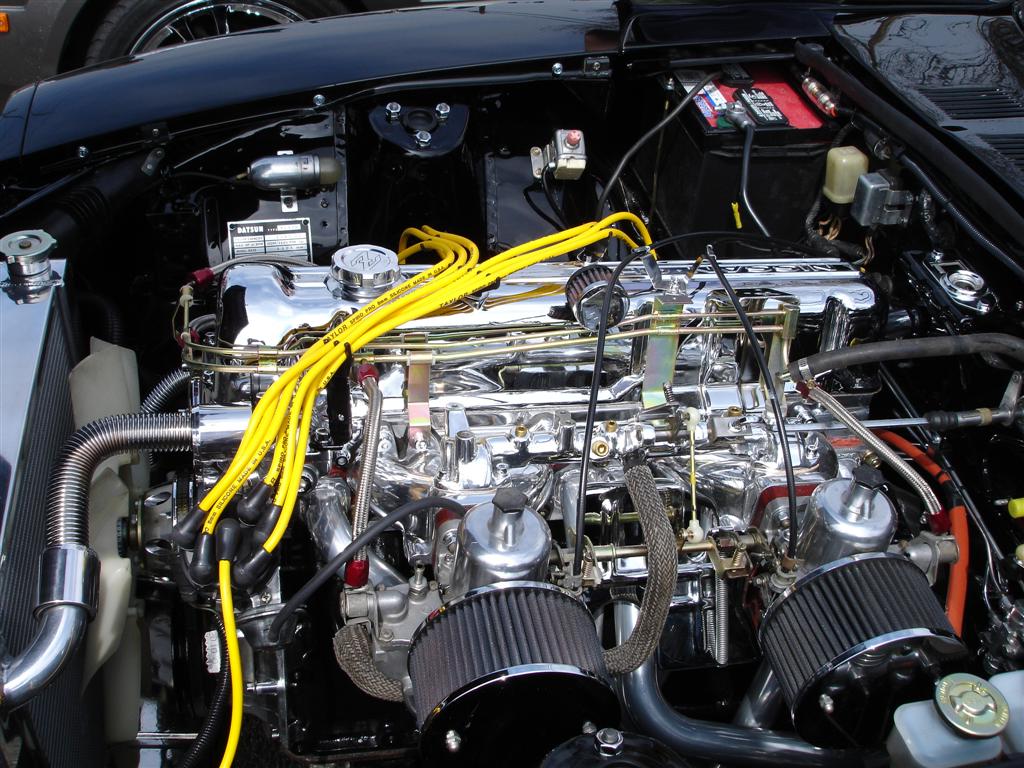

Can some of you guys post pictures of your battery install and hold-down ideas? I'm looking into various solutions since my battery tray has been completely removed.
We are considering welding in a stock tray, but, I'm not sure if that's the best idea or not. I'd like to go with an Optima battery and I doubt I'll put it in the car.
I'd like to find photos of any interesting solution out there. Of course, welding the stock tray back in place isn't a bad idea.....
Most cars I've seen are using the stock tray. ;)

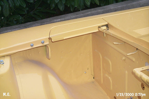

Here's what I did with my stock one. I was not going to weld the trap back under the battery tray. Now I can unbolt it and clean under it. I did weld nuts to the fender well when I was reworking the sheet metal there. I got the idea from some one who has bolts and nuts holding theirs.
In the FWIW dept. I think a7dz's solution to be the best solution for you with only a minor modification. Jon's would involve cutting, metal fabrication and welding and re-painting to effect, which at the stage of your restoration may be several steps backward.
Jim's is ideal in that it uses a basically stock tray, that instead of being welded in place is bolted in place. Where he welded the nuts to secure it to the back side of the fender, you could use nut-serts. Nut-serts are like a rivet with a nut on the end. That way you would get the advantage of the removeable tray without the disadvantage of having to re-build your fender well.
Hey, do you have finished pictures of this install? Or, does the picture relfect it's current state?
-- M
The engine bay is just short of paint. All other work has been done and I just finished painting the POR 15 over the bay. So, that is the latest picture.
