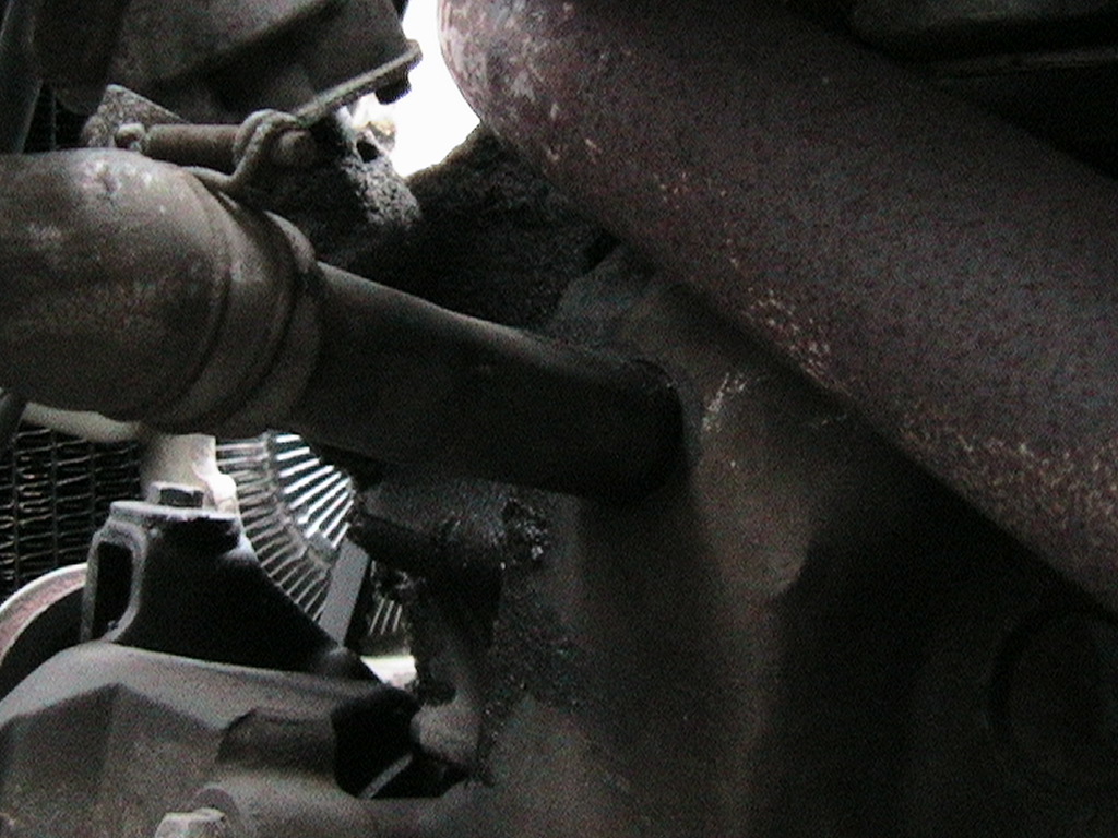

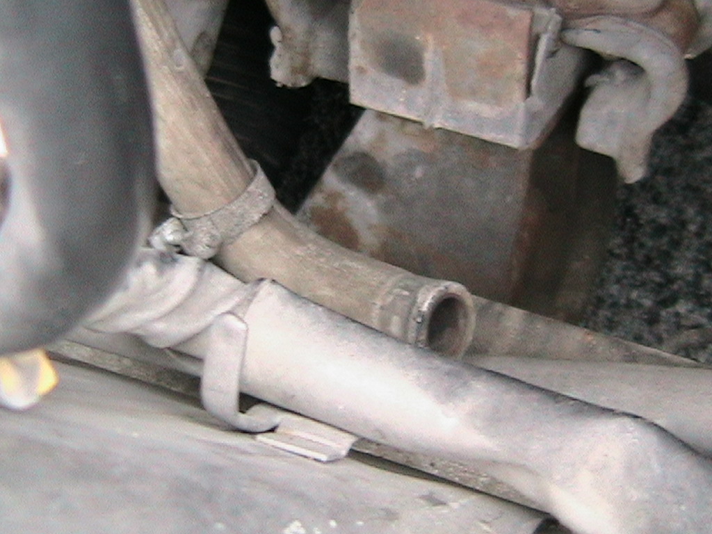

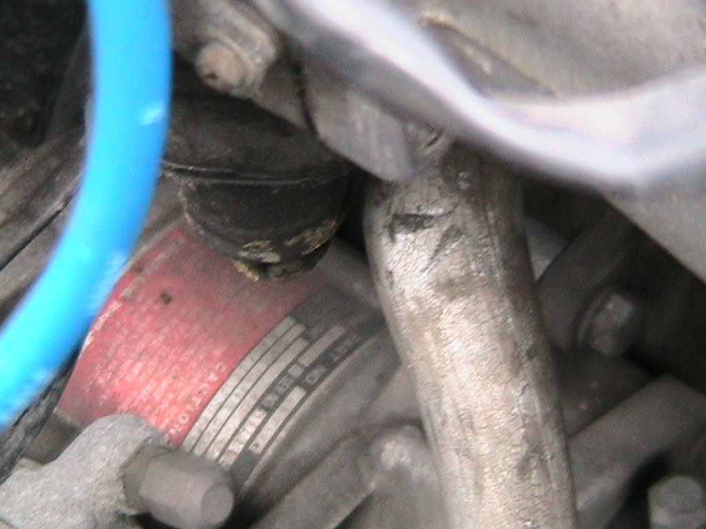

Posted August 26, 200618 yr comment_179972 The ultimate display in PO (and CO) dumbassery my friends.I finally figured out why my car idles like crap.Today I went hunting for my PCV valve, I figured I should check to see if it was making good vacuum or not.On the course of this little expedition I discovered a hose that didn't really go anywhere... It was painted the same color as the body, which meant that it had probably just been resting against the sidewalls of the engine-bay (at least since the car was last repainted in the late 80's.And I thought "Gee, that's kinda funny, hoses coming off of the engine usually connect to things."So I followed it, and sure enough I discovered the PCV valve... I was in utter disbelief... what kind of dumbasses (referring to two previous owners) wouldn't notice a disconnected PCV valve?So I started up my car and felt the hose, and sure enough there was a bit of a vacuum, not a lot, but some. I covered up the hose with my thumb, and boom, my idle suddenly jumped from an unsteady 800 to a very strong 1200, instantly! ... So someone in the past noticed the low idle after the hose came loose, and instead of inspecting the PCV valve... simply twisted out the idle screw... great...So naturally, I reconnected the hose, screwed in the idle adjust to bring it back to 800... and I have never been more thrilled in my life. The engine actually idles without the tach bouncing! AMAZING! ... to say nothing about when I opened 'er up on the highway... heheh...I'm gonna shoot some carbie cleaner into the PCV valve later to see if I can make it "whistle" like I guess it ought to.I also can't wait to see the exhaust when I fire it up cold. My Z is a notorious smoker... she likes to smoke when she's cold (be it a hint of burning oil mixed with a slightly over-rich fuel mixture)...... Anyone else care to relate their PO "horror stories?" Link to comment https://www.classiczcars.com/forums/topic/21330-previous-owner-dumbassery/ Share on other sites More sharing options...
August 26, 200618 yr Author comment_179973 Oh, I forgot, check these out. Link to comment https://www.classiczcars.com/forums/topic/21330-previous-owner-dumbassery/#findComment-179973 Share on other sites More sharing options...
