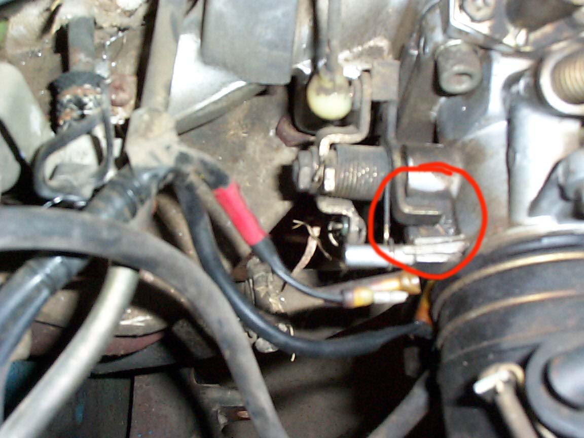

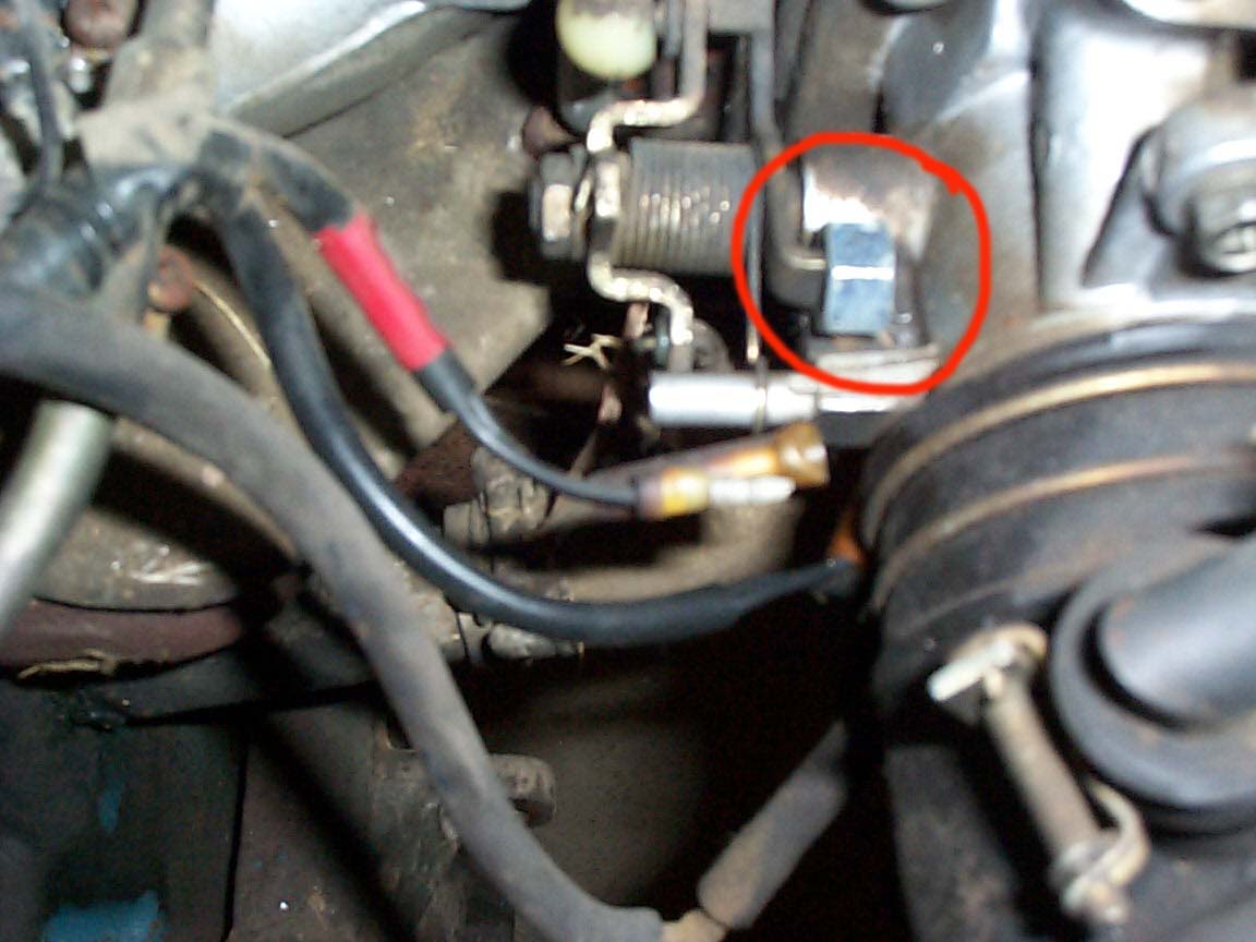

Hey guys, i fixed the problem. As it turns out, a nut had fallen on the throttle linkage down near the throttlebody and was not allowing it to go all the way down. No idea how it got there, but i noticed it looked like it wasn't going down all the way and there it was. Took a screwdriver and knocked it off. Now there arn't any problems. I took the pics below to show you where it was. These are on my spare motor so it is easier to see.
My question involves why there would be a loose nut floating about the engine compartment when all they did was tighten down a fuel line clamp and ball joints.
Would replacing the ball joints involve removing the strut?
And if that is the case, when they went to put it back and they discovered that they were shy one nut they just....what? Blew it off? Found another and disregarded where the original disappeared to? And, most importantly, after having done work on the car's steering they did not take it out for a test drive or even start it up to move it out of the bay? Hmmm, I would definitely have some quetions about their procedures.
Not to lambaste your mechanic, but something is fishy in the state of Kansas....and it's not a coastal state.
2¢
E
From the size of the nut it looks as though, like Blake said, it may be one of your strut fastening nuts! It seems very odd and highly unlikely that a nut that size found its way onto the throttle stop.....and it could have only gotten there with the throttle open! I smell fish too!!!
E
He said in his post that he took his car the the shop to have the ball joints replaced as well as the front struts. Which still leads to the faint odor of pescado!
Good catch Stephen, I missed that part.
But I agree with you, where were they putting the nuts they were removing that they didn't notice one missing....and further, why did they just go get another without questioning the missing part.
Then to top it off, No test drive? Or did that problem arise AFTER it had been picked up and driven a bit.
