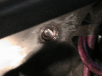

There is a small bolt to which leads off of the battery cables attach to.
This bolt is threaded into the metal "firewall" sheet... when I was tightening this bolt, it snapped and half of the bolt is still stuck in there, so the hole is pretty much useless.
I don't have the right stuff to tap a new hole like this one, so my plan is to remove the cowl, drill the hole and put a new bolt and nut in this hole.

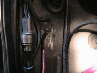

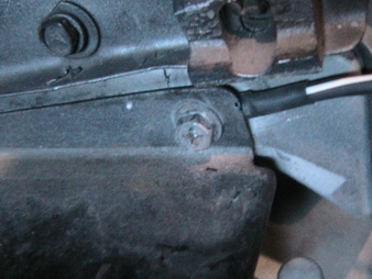

Here are some pictures for reference, hot off the digital presses!
As you can see, the broken bolt, the "new" locations to where I've put the ground cables, one to some kind of fitting that goes into the cowl, and the other to the metal directly above and behind the voltage regulator.

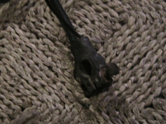

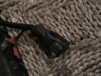

I also threw in some pics of my old battery terminals for reference.
That fitting into the cowl is your windshield washer nozzle.
Those battery terminals seem awfully dark on the inside, be sure to give them a solid brush out to effect good contact.
If you did in fact clean to the metal on both of those metal pieces where you have the battery ground bolted to, that is both of the sections touching the lead, then you should have both enough and proper ground.
Check your voltage between the poles at the battery, then between the positive pole and a point on the body metal and compare the reading. Your two readings should almost be identical with only a MINOR variation.
But to go through all the trouble you're mentioning to open up the cowl JUST to put a bolt through....seems excessive and unnecessary.
