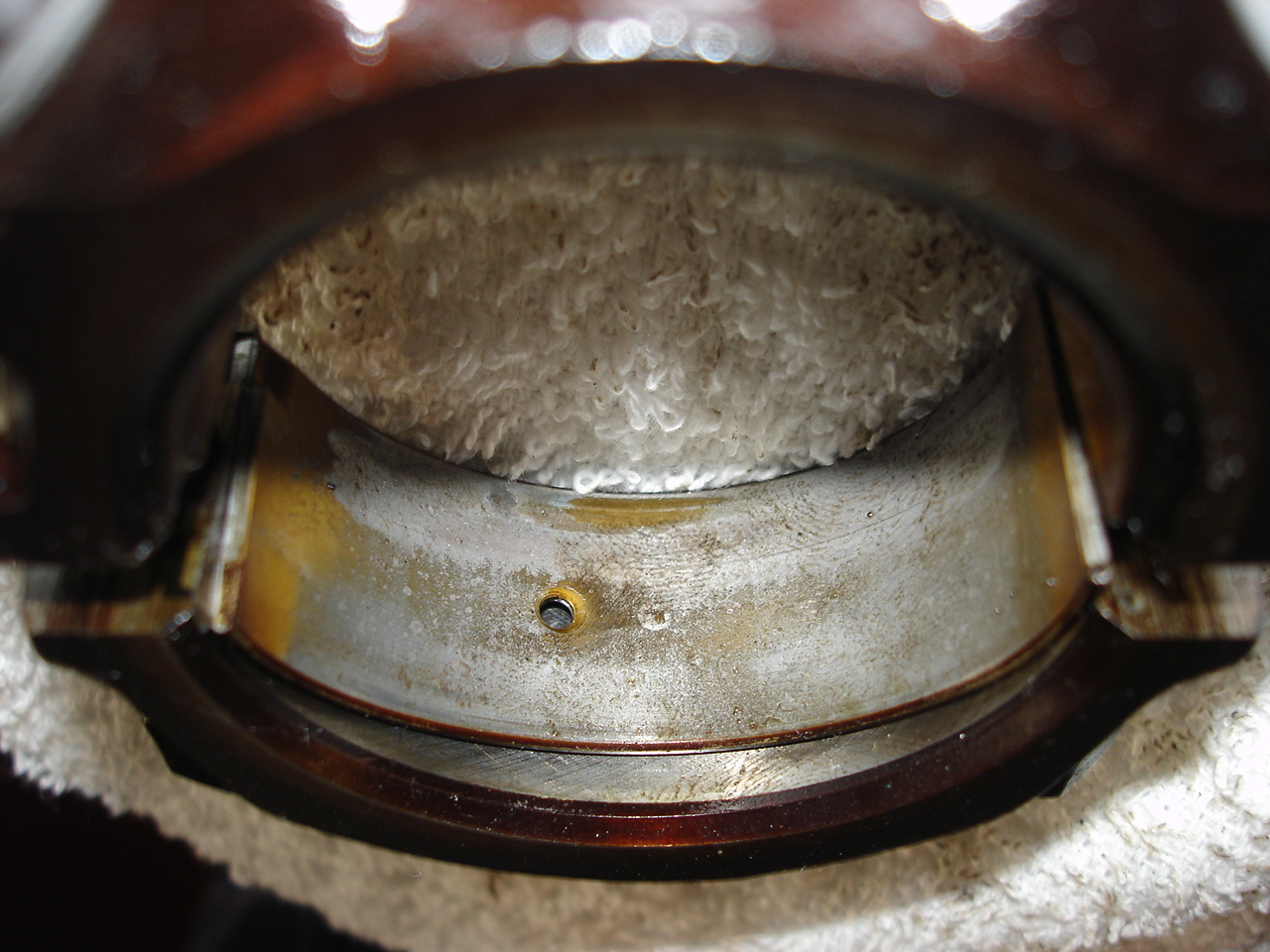

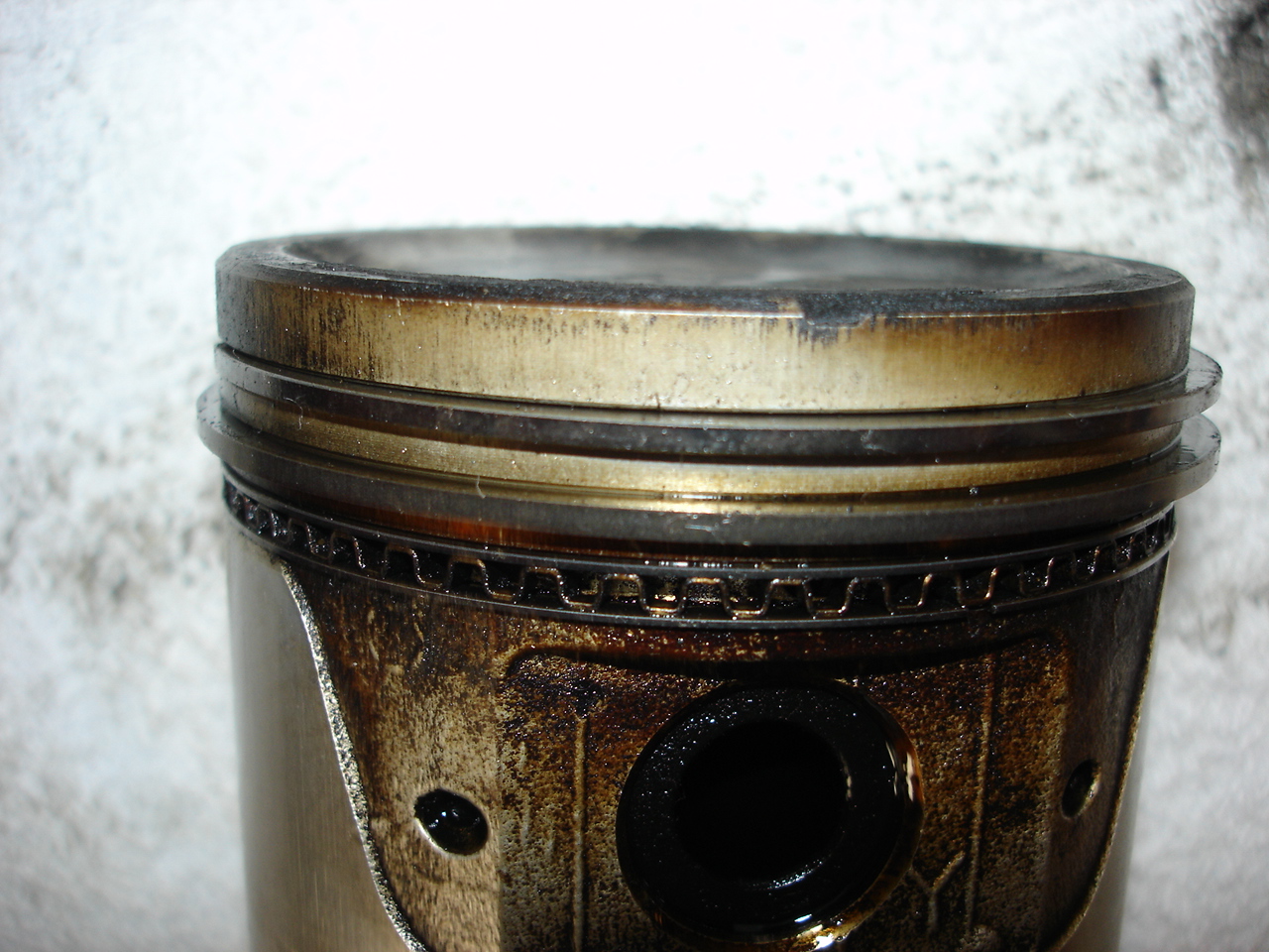

OK ! pulled the pistons, here's #6 which seemed to be the worst of all. Which ring is which , from top down. the only thing I noticed was the bottom set doesnt stick out near as much as the top 2 rings, bearings didnt look bad at all (from what I can remeber they are supposed to look like), crank rod mounting surfaces are clean, slick un scarred.

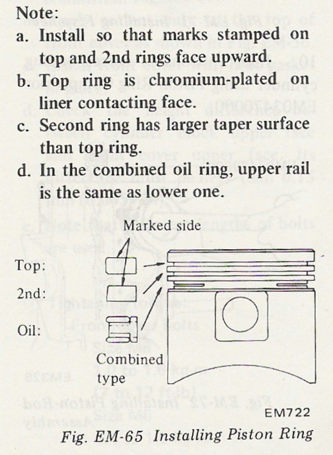

The bottom one is the oil ring and it does appear to be collapsed. The top ring is the one that sits flat against the cylinder wall and the second ring is the tapered one that mounts with the tapered surface downward. I forget the actual names but I learned from once installing them wrong in a L16.
can you expond on the TAPPER, dont see anything that would make me say HEY ITS TAPPERD, and looking at these ( could be stock I dont see any MARKINGS), going to order new $^!# today!
The second ring is kind of trapezoid shaped when you view it from the side. The larger part goes toward te bottom.
I just finished rebuilding my engine and had to go through 3 sets of rings from different manufacturers before I found one with an acceptable end gap. Each one had a different shape (cross section of the ring). You need to assemble the rings per the instructions from the ring manufacturer. Just take your time and go slow. I reread the instructions several times to make sure I wasn't getting something upside down. Tunes were turned off for this step :)
