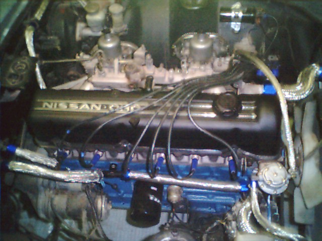

As far as whats wrong with the su set-up. asfar as I can tell nothing. I got this car 9 mo. ago. The person I got it from had redone the whole driveline. He owns A perf. auto shop and had the motor fully blueprinted @ .020 over with top-end done to match with A killer cam fresh 4 speed & limited slip rear-end.
After all that work the car went on the back burner for him. It sat covered in the corner of his shop for 5 years. I was in the shop and saw the Z lines with A cover over it and asked about it. Bang 8 years of looking for A rust free 240Z was over. Anyway the intake was bolted up with the early sus aftermarket cage style air cleaners and no vac. lines run. We got it started (needed to hear it run before money changed hands) after getting it home I started working on getting things set-up proper for the su's but just sick of playing with carbs and have not been able to find A spec. sheet for what vac. lines go where.

You know Miami is not that far from Tulsa. One of these weekends maybe we can bump heads and try to figure those carbs out. More than likely, however, it simply sat for awhile. Carbs can be tricky and despite being SU's, if they sat for 5 years they may need a good rebuilding. Thrashers carb shop here in Tulsa does a decent job, or you may consider going for the already rebuilt SU carbs from Z therapy ( www.ztherapy.com ). Like I said I had a pair and they were great. Scott at Ztherapy talked with me on the phone for a long time before and explained how he rebuilds them using 'gross jets'. Good stuff. I was fortunate enough to get '70 model SU carbs for my '73 240Z. Of course I had to sell it. Bummer too because I loved that car. If you do get a good running '83, check the block and head casting number. Block is located on passenger side, below cylinder #5. Head is on head (duh) between cylinders 1 and 2. I would strongly consider rebuilding this engine and dropping it in your Z. You might also want to grab the ZX 5-speed and R200 rear end, they drop in your 240Z as well. If you do choose to go with the ZX 5-speed, get a '78 280Z shifter handle. It mounts on your transmission and will clear the tunnel fine. No cutting, looks factory. No much else is useful from the 280ZX unless you want to do a rear disc brake conversion. There are a couple schools of thought on this, some use the rear ZX disc brakes and fab the mount. I have heard of using the fron t brakes and flipping them backwards. Downside to this is there is no way to utilize the emergency brake. Lemme know how it goes. Oh there is the most important matter for your new Z;
