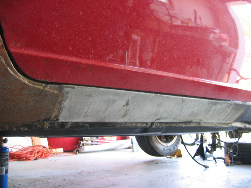

I need some professional opinions here, heres my problem: Last year I had new floor pans, rockers, and rails put into the car.
I got a really good price and the guy came recommended from someone at work. After he quoted me, it turned out to be more work than he thought, but he gave me the price he quoted and his guy did the work between jobs. All good so far.
I got the car towed home and put it in the garage. I saw it alot at the shop, but didnt see it with the doors on till after it got towed home. I put it in the garage for winter then I just now noticed the gap on the drivers side between the bottom of the door and the rocker is a bit much.

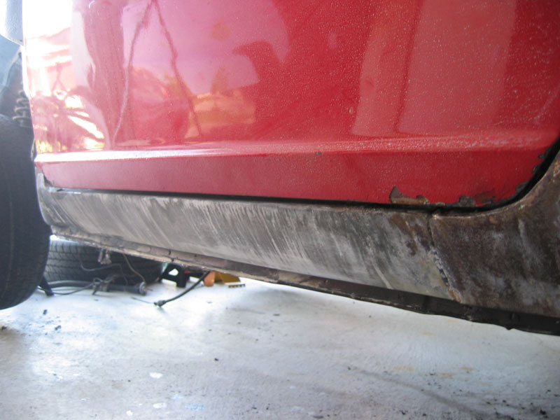

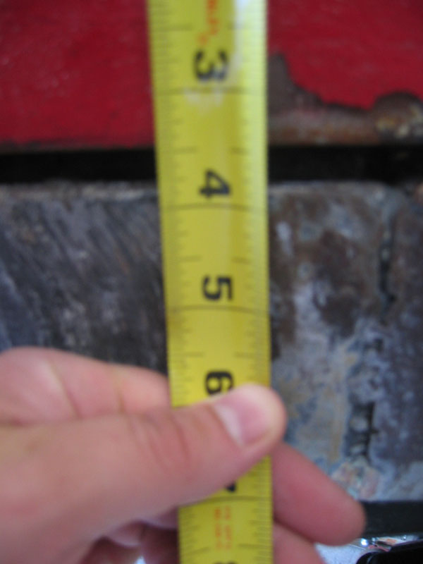

The passenger side is ok, but the drivers side is about 1/2". the gap is almost enough to stick my pinky finger in there.
I really dont want to have to take it back to that place and try and get the guy to re-do it. I just dont want the car hacked up again after getting back. It cant be good to hack up all that work to lift it, about 1/4 inch maybe?
Im getting a different guy to do the prep/paint, and am hoping that it can be fixed by building that area up a bit to even it off. Which I'm sure can be done...but is there anything wrong with that?
Look at the pics and tell me what you think. Thanks.
Zak

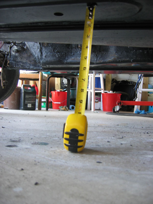

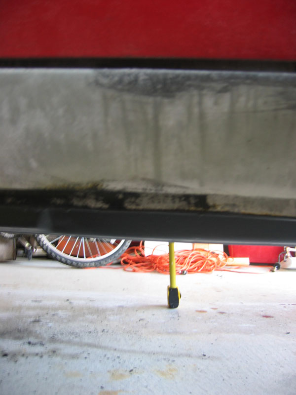

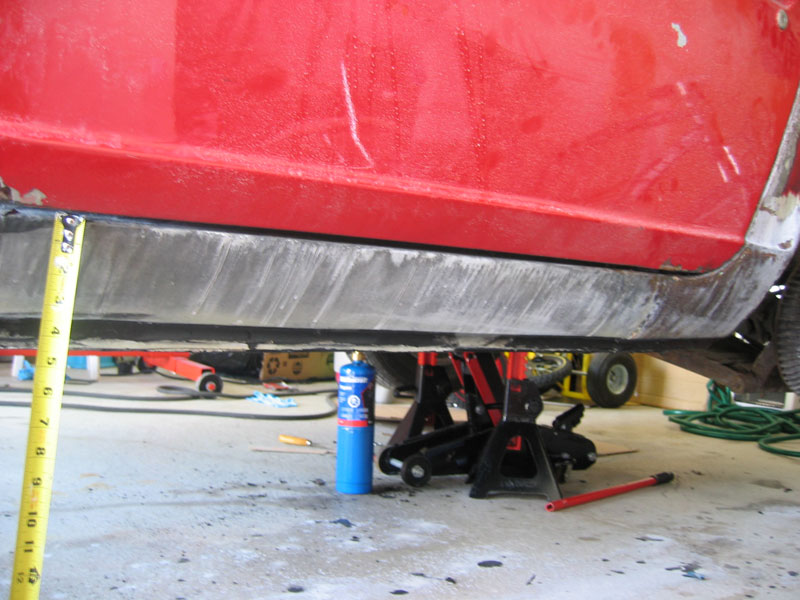

Even the drivers floor pan is about 1/4, not quite 1/2 inches lower. heres the passenger side for reference. And the doors on both are lined up properly at the top as far as height goes.I cant move it down any on the drivers side or it wont line up correctly.
EDIT: Im already reserved to the fact that this wont be a showcar, but I am putting an awful lot of work and $$ into it, so I want it to look nice, and be mechanically sound and all that.
zak

Your passenger side pic shows a fairly discrete "shoulder" where the rocker was welded in (see annotated pic) Are you sure it's right and the driver side wrong? Just eyeballing it, it looks like the driver's side may be closer to accurate than the passenger side....
I see what you mean. When I look at passenger side, looking at it level and from about 3 feet away..it looks pretty close, although maybe a touch too tight like you say.
The drivers side is 'more' off than the passenger side though.
So now I have one side too high, and one side too low.
Any thought of how that will affect the door closing when the weatherstrip is on? Any other possible problems may arise out of this other than cosmetic?
