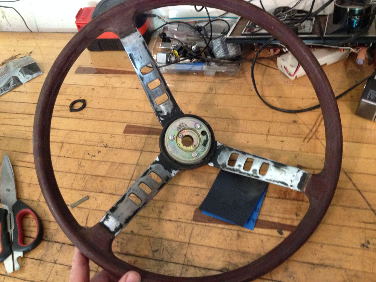

My concern is that my wheel had a number of areas where the top layer is worn away. All that is left is the base core with no woodgrain- so, it's just single color plastic. My experience with stains is that they just accentuate existing woodgrain. Applying stain to these high wear areas is just going to change the color- not create a woodgrain. Thoughts?

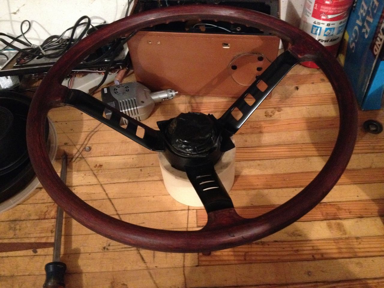

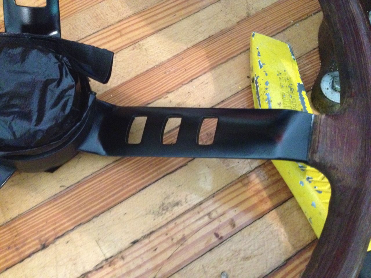

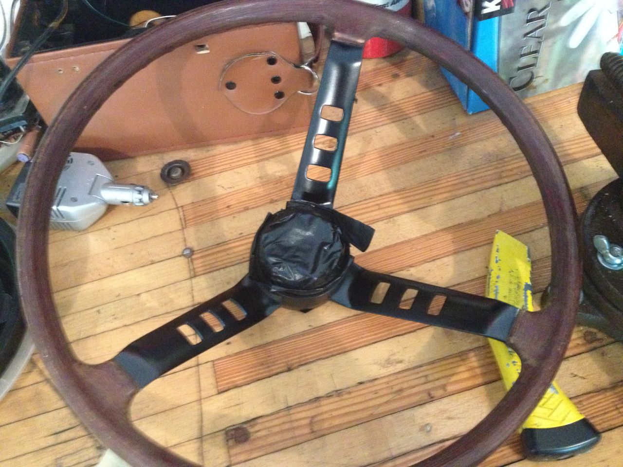

I think if you sand it smooth (maybe 320 grit sand paper) and get some stain on it, its going to look great. The 240Z wheel I picked up a couple of months ago looked pretty rough before I started but it came out nice.

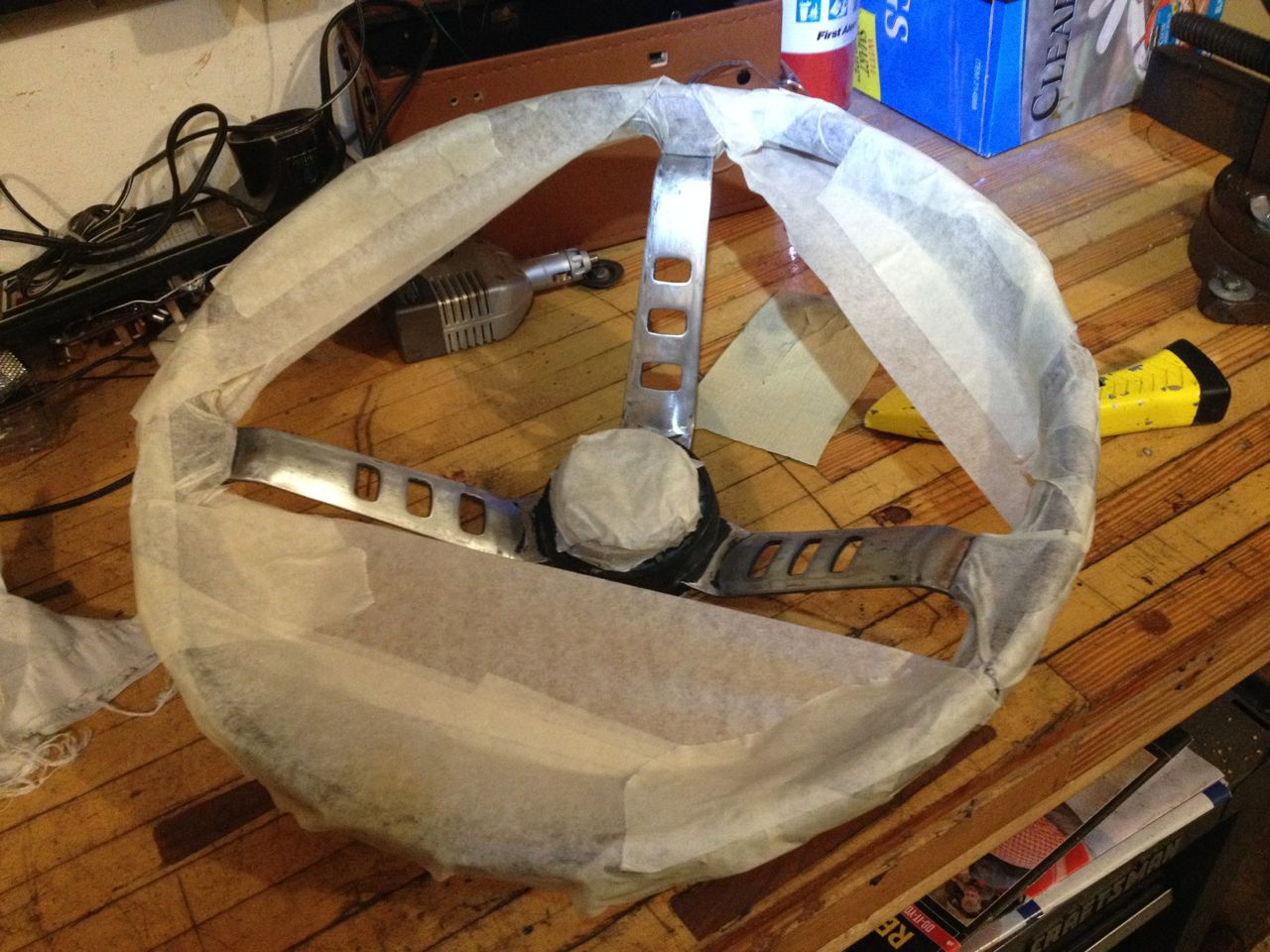

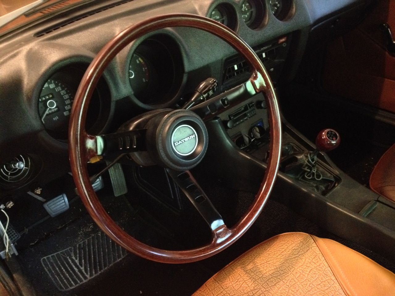

I just did mine last weekend, pretty much following the above process (stain, then I think I had 5 or 6 VERY thin coats of spar urethane applied with a small foam brush, treated between coats with 000 steel wool):
