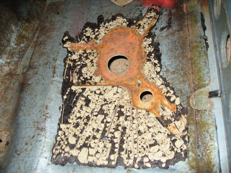

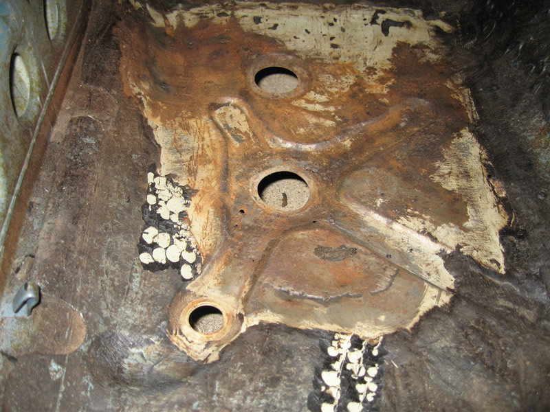

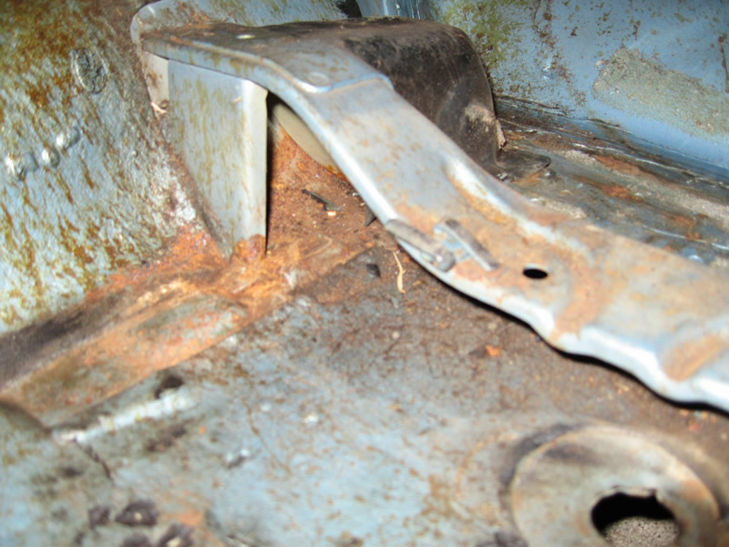

The first problem I want to address are the floor pans. I have attached some photos to show the extent of the damage. The driver side is rotted through with three pin hole size spots. The passenger side has rust in the same area but isn't all the way through.

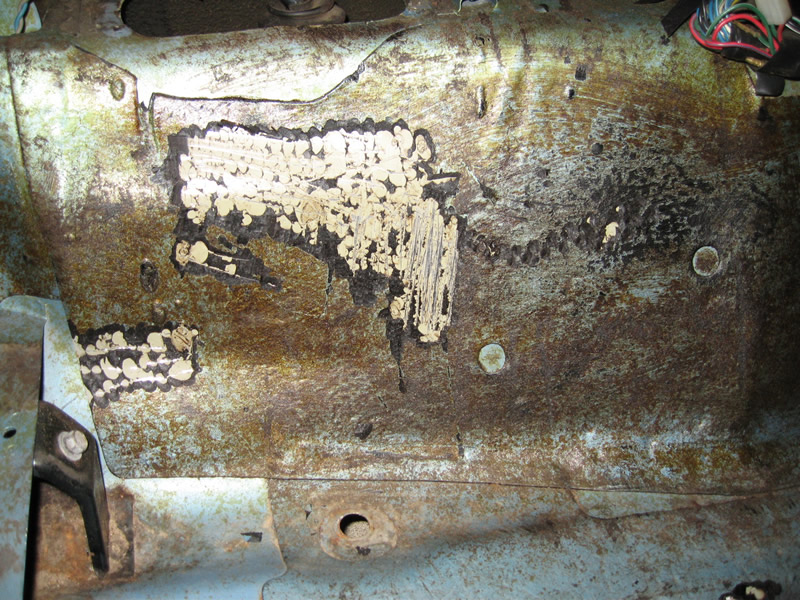

The entire area of my floor board seems to be covered in this tar crap and it is making it quite fun to try and find the rust and treat it. It's all over most of the area including the console area.
Can I just spray paint stripper or aircraft remover to this stuff and get it off that way or should I just manually chip away at the bulk of it (as I started to do) and then get the leftover with paint remover? Do I need to worry about the transmission/console part of the interior (where I am 98% positive there is no rust) or can I just strip the floor pans and focus on that area (where I know there is rust)?
I will also be redoing the underside of the car so I will get to any rust on that side also.

When I did my floorpans I found only a smattering of pinholes, but felt that overall the pans were not in good shape--flakes of rust, thin spots etc--so I bit the bullet and bought new pans from Zedd Findings and had them welded in--total cost about $900
The soundproofing extends a ways up the trans tunnel, so I would take as much of it off as you can.

Gregg, ditto to what has been said above. I used a gasket scraper and most came off in chunks. I would take as much on the trans tunnel as you can. I found surface rust way up the tunnel that I didn't think was there. Same in the back, take it all off if you can. To me your pans didn't look too bad. The area under the seat mount may be patched but the rest might make it

My floor pan was split lingth wise about 18'' on the passenger side floor. Outboard of center and rusted badly . This side I replaced with a Zedd floor pan . On the driver side I had pin holes in one area just ahead of the seat . This area I repaired with POR and POR matt. You need to be the judge , if the metal is thin from rust , replace it. As to the tar matt . I only removed it up the side of the tranny tunnel about 2'' above where I found zero rust. I can see no need to remove it , if it is rust free then apply more. From the pictures it looks like heavy rust scale on the driver side by the rocker . Have a long look at this area. With this type of unibody construction the floor is part of the frame so keep this in mind . I sand blasted all bare metal and any rust , did the necessary repairs . Then treated the metal as directed by POR 15 and used there products to treat the floors both inside and under the car . Your floors from the pictures don't look to be in that bad of shape , but pictures don't always tell all . Have a good look under the tar matt in the back floor and around the spair well . I have pictures if you are interested, send me a PM Gary
