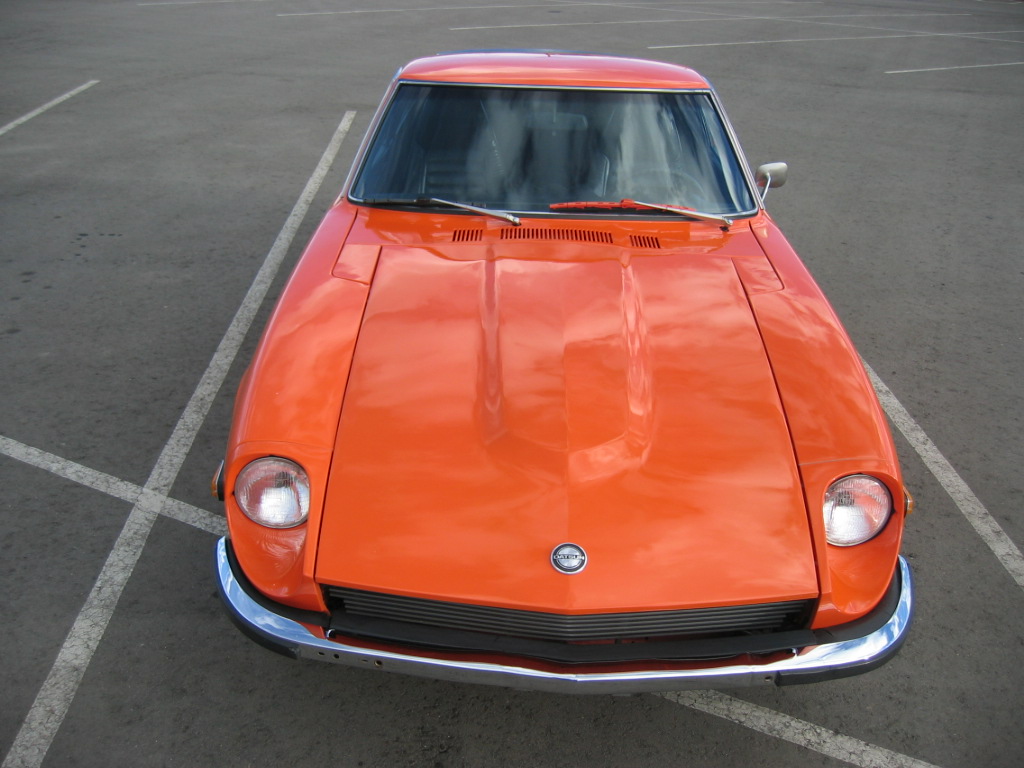

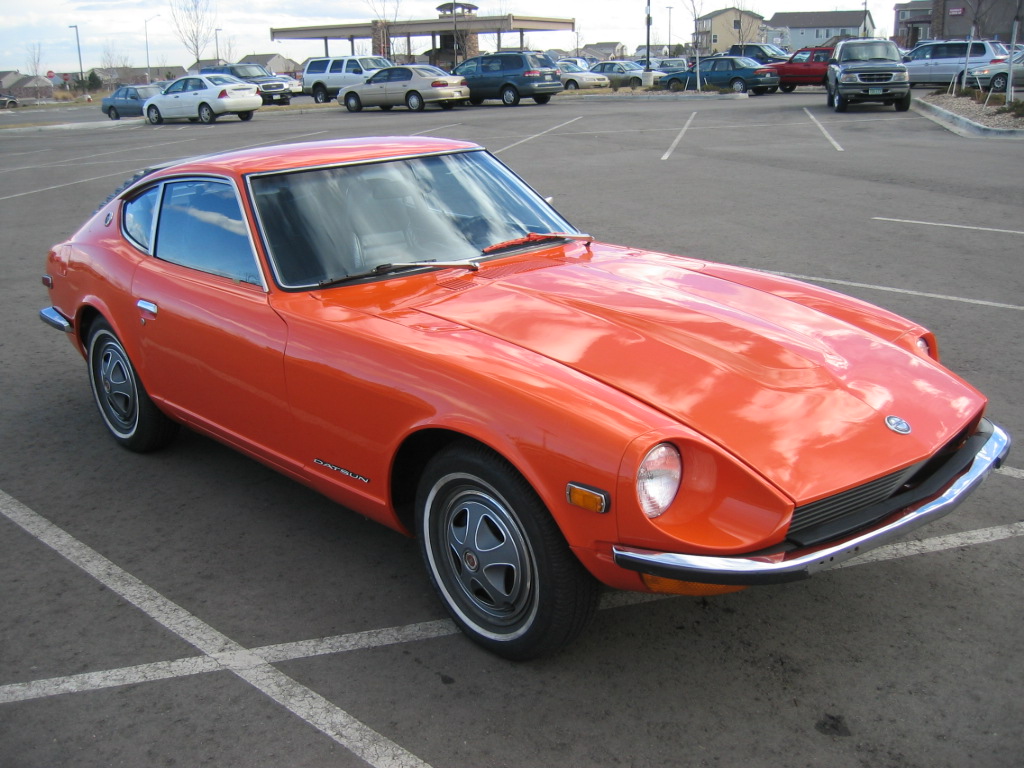

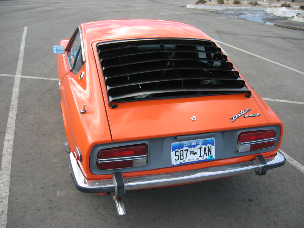

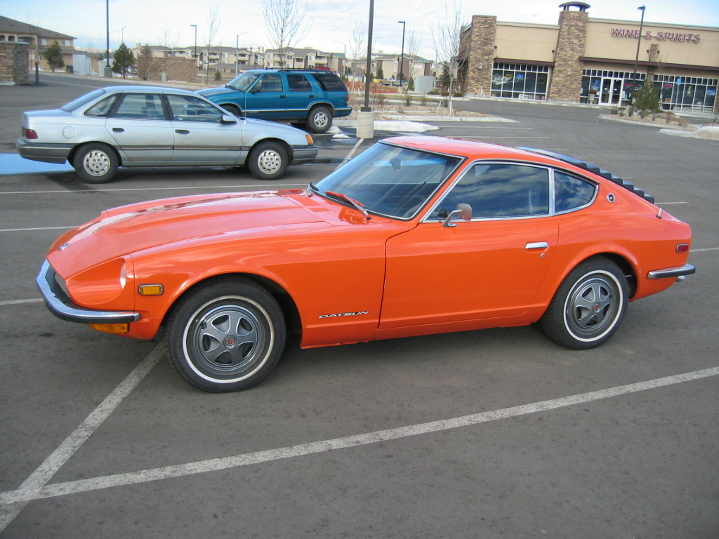

Hi Carl, (dat240z71),
Here are some pics of my car, taken outside in the sun.
I used PPG's Omni AU acrylic urethane paint, consisting of an orange basecoat covered with a clear coat. Here's the paint code and tinting guide that was on the can:
MBC 69982 B Orange
Tinting guide:
M130 975.9 Orange
M114 710.7 Yellow
M120 82.2 White
M118 45.6 Black
M150 1815.0 Basemake
Please let me know if you have any questions.
