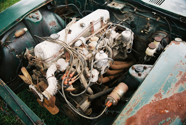

In all my experience in all my years of fooling with SUs, the engine electronics is 75% of the problem. The rest of it is timing and carburetor adjustment. Make sure your electrics are in top performance meaning brand new. The service life is far gone for original equipment. Make note that original spark plug wires were dated. If you a set of dated wires, keep them. If the old black distributor cap has copper contacts, keep it. My suggestion would be to replace all the electrics, set the timing and valve clearance before I looked at the carbs. Now, they may have some varnish build-up and I'll go along with the suggestion of getting a book or video before you take them apart and clean them.
I'll bet they look better than this!
