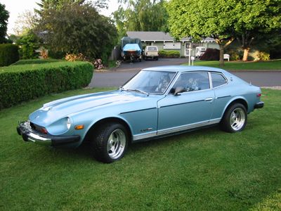

May 28, 200223 yr Author comment_7884 Here's a picture of the car as of today.... Link to comment https://www.classiczcars.com/forums/topic/1776-280z-22-update/#findComment-7884 Share on other sites More sharing options...
