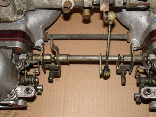

My SUs arrived yesterday. A decent set of 4 screw round-tops on E88 manifolds. After searching and studying old posts and pictures, I think I've got it all figured out - what connects where and such. But I noticed that the center linkage between my carbs doesn't look like other pictures, it seems to have an extra lever near the front carb. (See pics below.) Would this have perhaps been for the optional hand throttle?

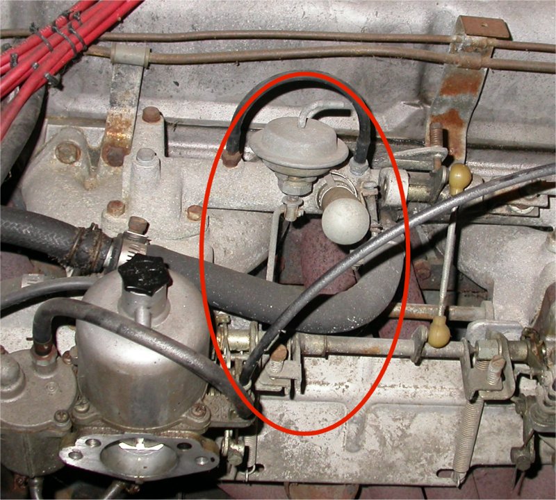

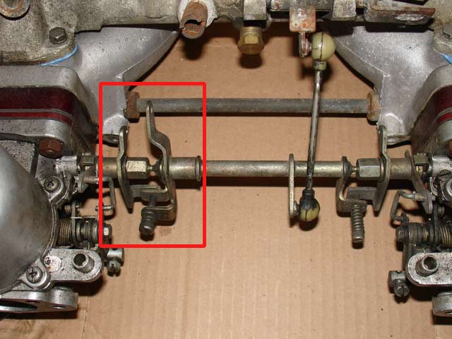

As for your "extra" part, if you are talking about what I have highlited in the attached pic that is normal and connects to nothing.

OK, that's the one. My eyes must be getting bad, I had gone to ZTherapy's site and could have sworn that the linkages pictured there didn't have it. Of course, when I go back today and really stare at them,now I see it.
So I just let it rattle around there?
Doesn't that linkage connect to the deceleration dashpot that many have removed from their cars?
Right you are on both accounts! I have never seen a Z with this item still installed...nor have I even heard of it.
Please tell me about it's purpose and the pros/cons of removing it.
I believe it is a small vacuum valve that "damps" the throttle closure for emmissions purposes. So if you quickly take your foot off the gas, this device slightly slows the throttle closure and allows a little more air into the manifold. This keeps a rich slug of mixture from moving through the system, so you don't get a burst of unburned fuel out the tailpipe.
That's what I THINK it is for. I can't see how it would affect power at all, so it is an emissions device that I dont' see any harm in leaving alone. When I get to actually working on the engine restore on my 240, I'm going to restore the entire air injection system.

Makes sense, I think you're right. What emissions engineers call "drop throttle" conditions are one of the biggest sources of tailpipe emissions.
