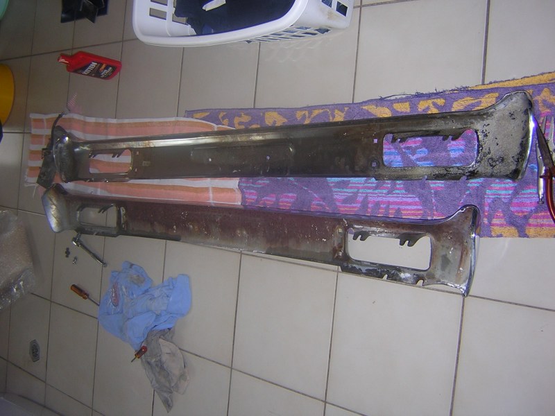

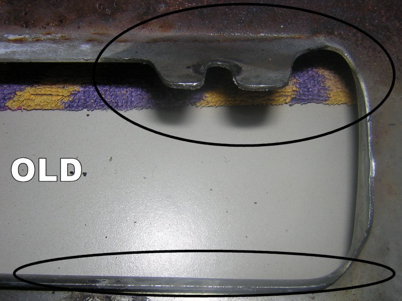

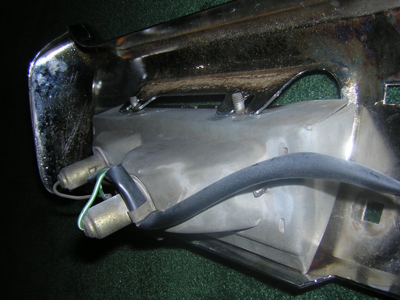

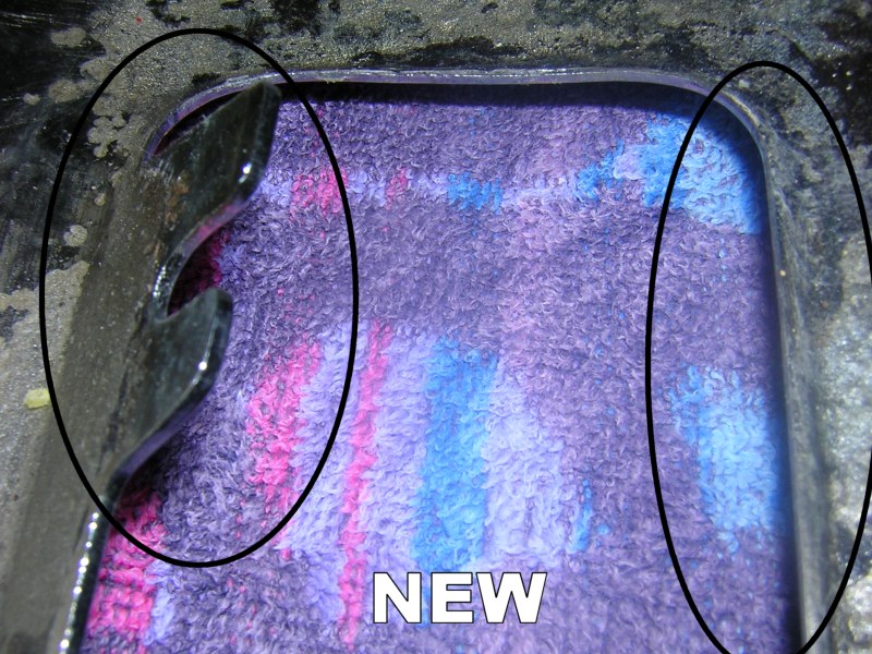

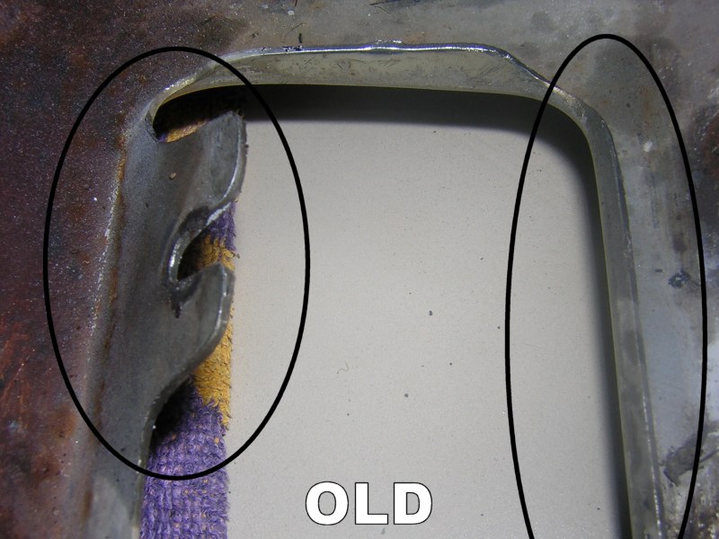

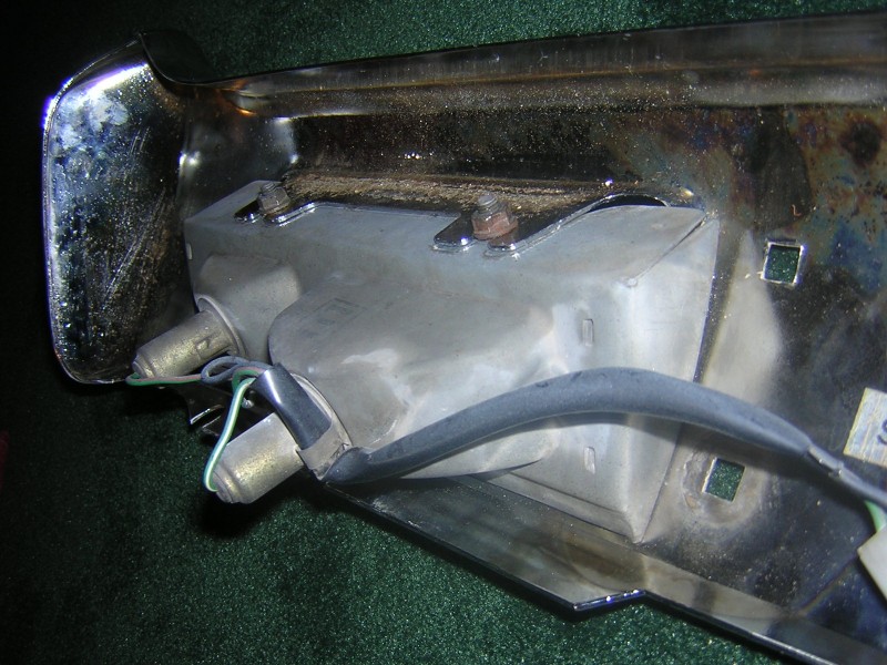

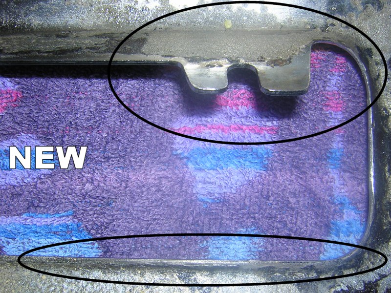

Posted October 12, 200519 yr comment_141389 Hello! Well I've got a new front bumper for my car. The old one is still nice but it has a few scratches on it and paint etc. and the chrome is old. Anyway, my problem is getting the indicators into the new one. They just wont fit! I've attached a whole load of pictures for you to look at. Therre are two places where it looks like the indicator unit wont fit. Firstly the upper bit where it actually bolts on, the ANGLE here is wrong. The flat part here should lie flush with the top of the indicator unit. Secondly, the angle of the lower bevel part is different. On my old one it comes back at a reflex angle to run parallel with the angle of the top part. On this one it is a nicer, but acute angle - the same as on the sides. I'm not sure if this will cause a problem yet but it is a difference. This is a rechromed bumper. It is quite possible (and probable) that it's just been bent. but the lower part doesn't look like it could be bent like that... The other option is there are differences between the late and early model cars. Wouldn't think so though... I have two questions then. Firstly, can you please check out your bumper! You will be able to see the angle of the lower part without taking the bumper off, so don't worry about that. I'm just curious about this. Secondly, how can I bend the thing back to the right angle Sigh, I took the front of the car apart so quickly, I thought it was going to be way easier than the rear bumper. Link to comment https://www.classiczcars.com/forums/topic/17591-help-lateearly-model-240k-front-bumper-differences/ Share on other sites More sharing options...

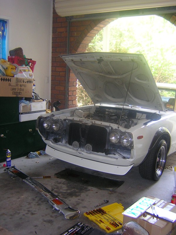

October 12, 200519 yr Author comment_141390 And this is what a C110 looks like without bumper or grille :beard: Link to comment https://www.classiczcars.com/forums/topic/17591-help-lateearly-model-240k-front-bumper-differences/#findComment-141390 Share on other sites More sharing options...
October 12, 200519 yr comment_141408 Look like you could just use a grinder and smooth the edges down and it would work.Chris Link to comment https://www.classiczcars.com/forums/topic/17591-help-lateearly-model-240k-front-bumper-differences/#findComment-141408 Share on other sites More sharing options...
October 12, 200519 yr comment_141445 I'll take a close look at mine on the weekend. Its a 77. You might have to get some later model indicators. Link to comment https://www.classiczcars.com/forums/topic/17591-help-lateearly-model-240k-front-bumper-differences/#findComment-141445 Share on other sites More sharing options...

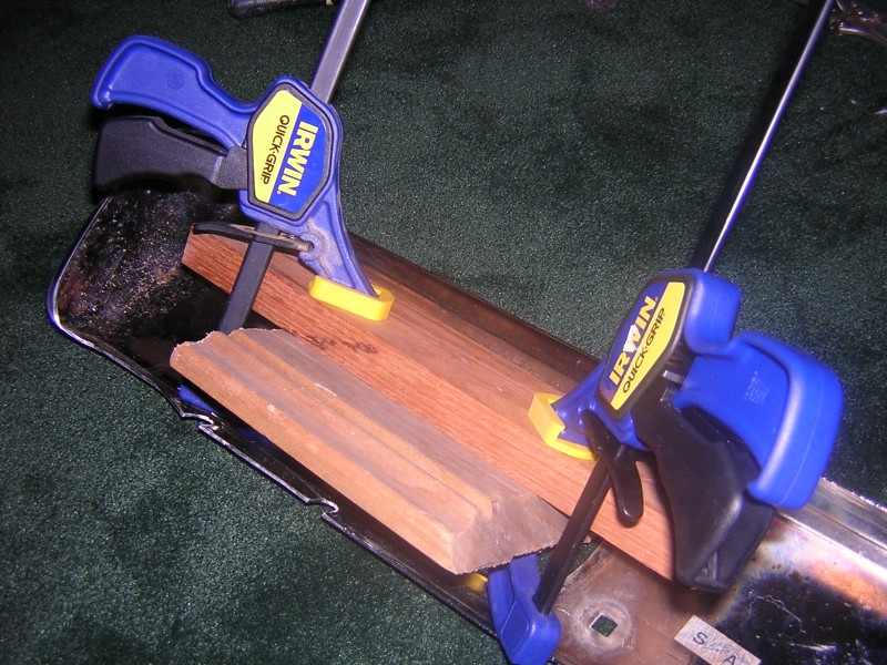

October 12, 200519 yr Author comment_141508 Chris - at first it seems likely but the indicator unit fits very snugly and flush with the flat metal piece. Grinding wont work... Craig - when did you get a C110?? Post a picture if you can Thanks for having a look. I don't think there would be differences - mainly because on the new bumper, one side is bent more than the other. I'm going to try with two flat pieces of wood, clamps and leverage. Hope the chrome doesn't crack too badly Link to comment https://www.classiczcars.com/forums/topic/17591-help-lateearly-model-240k-front-bumper-differences/#findComment-141508 Share on other sites More sharing options...

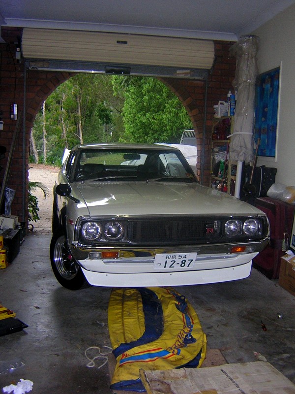

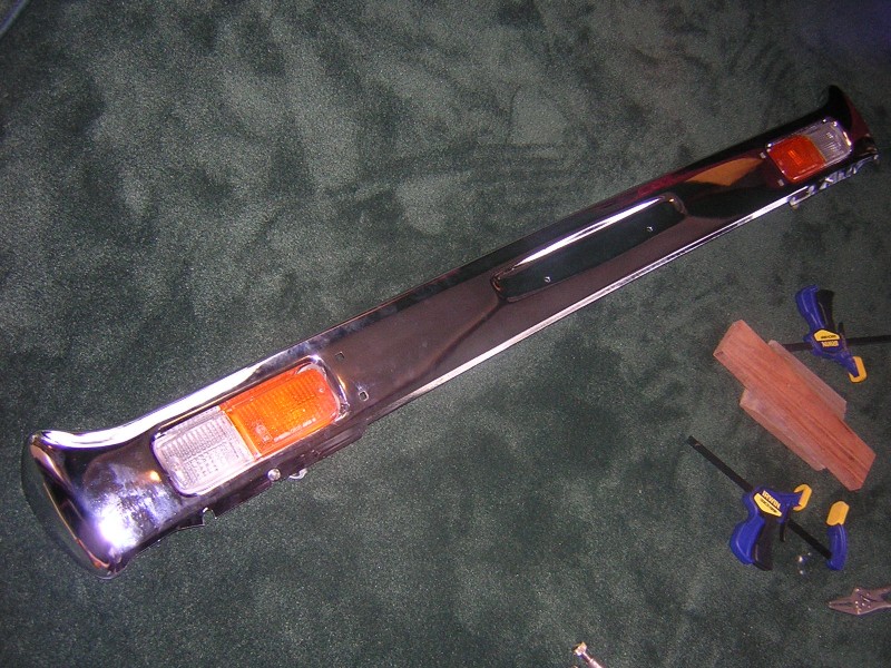

October 13, 200519 yr Author comment_141557 OK, done! Chopped some wood, clamped it on, used muscle. Not the most accurate way but it worked well and the bumper looks fantastic. Now, about those stainless steel trims... Link to comment https://www.classiczcars.com/forums/topic/17591-help-lateearly-model-240k-front-bumper-differences/#findComment-141557 Share on other sites More sharing options...
October 14, 200519 yr comment_141679 holy crap your 240k looks awesome i havent seen pics in a while...oh man! i cant wait to finish mine up.......so what are you gonna do with your old bumper??? hehehehe nice car lachlan i love itmikey Link to comment https://www.classiczcars.com/forums/topic/17591-help-lateearly-model-240k-front-bumper-differences/#findComment-141679 Share on other sites More sharing options...
