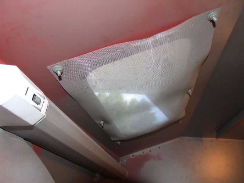

June 7, 200916 yr comment_285946 This is what I want to adapt to my cabinet. After reading your post John, I looked in the Snap-on catalog under blasting accessories for the screen, or a kit, but they only list the window replacement films. Do you have a part number for the screen or can you describe it? How is it held in place? Hi, Ron (geezer) and anyone interested. Sorry I didn't get back to this sooner. The mesh that protects my blasting cabinet window is NOT plastic, it is a tightly woven metal mesh. (I apologize for mistakenly advising that it is plastic. A friend has one that has a plastic mesh, and I confused the two I guess). It's a rather stiff mesh, too. It is held on with nuts, bolts, and washers - a very simple set-up. Under normal use, the cabinet window won't be taking a direct blast from the gun anyway, so what it is deflecting has already lost a fair amount of its speed and impact power. I checked the parts list that I have and it only lists "window glass covers", not a screen. My unit, although a Snap-On system, was actually manufactured by a company known as "dee-blast" in Stevensville, MI. The owner, Al Johnson has been quite helpful to me several times. Their web-site is/http://www.dee-blast.com/ I'll attach a picture so you can see what I'm talking about. This is looking in from the side and up at the window. Link to comment https://www.classiczcars.com/forums/topic/16303-blast-cabinet-question/?&page=4#findComment-285946 Share on other sites More sharing options...
June 7, 200916 yr comment_285969 Thanks John. Your blast cabinet has been used quite a bit over the last few years. How do I know that? I look in at your gallery every so often. If the metal mesh you are using has held up this long, it may be the answer. I'm pretty sure that nylon, steel, or stainless steel mesh would all serve to protect the glass. I used steel mesh to protect the glass on my lights, but at the time never thought of using it for the window, because I was using the plastic overlays that came with the cabinet. Now that I realize how often the overlays have to be replaced and at what cost, along with the resurrection of this thread, I have become interested in alternatives. Thanks for the deeblast link...nice equipment, but out of my league for my limited usage. I will keep them in mind for a possible source of the steel mesh....just in case my man in Savannah falls flat. Link to comment https://www.classiczcars.com/forums/topic/16303-blast-cabinet-question/?&page=4#findComment-285969 Share on other sites More sharing options...
