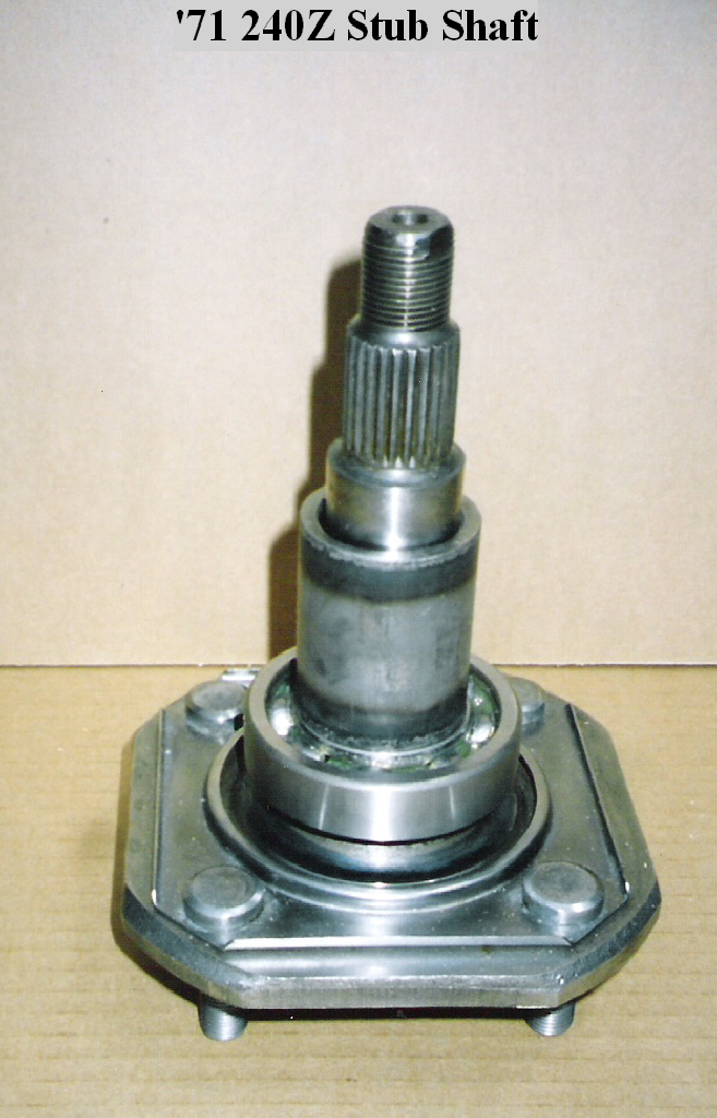

The red stuff you see around the axle nut may be Locktite. If it's the really good stuff you may have to use some heat to break the nut loose. My impact wrench is a CP 734 and it has no problem with the axle nuts. Be ready to use a tap and die on the threads because more than likely they will get messed up. The original nuts can be reused. Just use Locktite on them upon reassembly. Good Luck.

Recommend you use dremel to cut away the crimped part of the nut before trying to untorque. Will reduce amount of breakaway torque required and also minimize risk of damaging threads on stub axle. You will need a good 27 mm socket for the nut which was probably installed with over 200 ft-lbs of torque.

If I can get a replacement (which it looks like I should be able to), I will dremel the peened portion first. With everything already off the car, I can do it very carefully and hopefully not hurt the threads.
