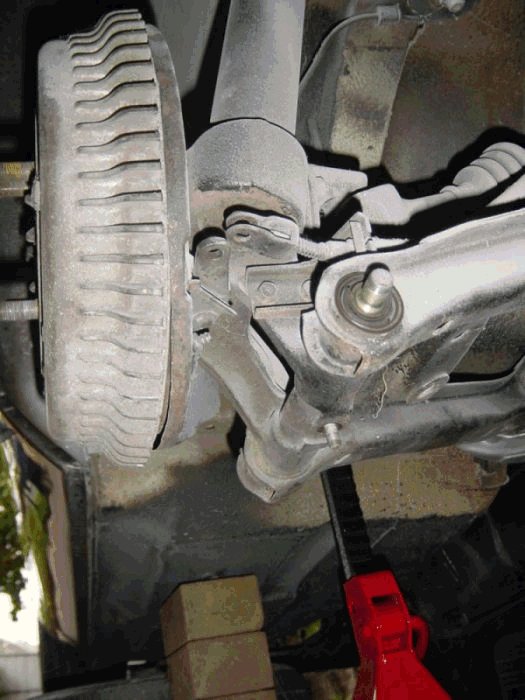

I'd get a drift pin (Long skinny one) and drive it out the rest of the way from the bottom after you soak it really good with some penetrating fluid (I.E. - PB Blaster, WD 40, Seafoam - Deep Creep or your own personal choice. Hope you have a new pin/washer/nut to go back in there and maybe the spindle pins also? (I see them on eBay from time to time as well as the locking pin) Have attached a picture that shows the locking pin sticking out for reference. In regards to the rear bearing R/R see the following website: http://www.atlanticz.ca for a "How To". It's in the "Tech Section". It's pretty large so I hope you have a cable modem in case you want to get it for future reference.

Having that picture really helps. It looks like i should be able to put the strut in the car and place a jack or something similar to press up to get it out.

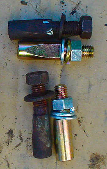

I found a really good picture that shows the "Locking bolt" in a "Rusted" vs. "New" condition. I guess you can see why it's such a PITA to get out because of all the rust. Might help somebody out down the road as you have to line up the flat space on the locking bolt with the spindle pin cutout during reassembly.
