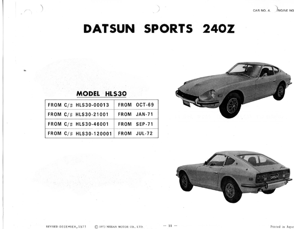

From the Datsun 260Z - 240Z USA and Canada Parts Catalog; December 1973. Your car is a 1972, perhaps titled as a 1973, but titles are irrelevant in my opinion. Check the data plate on your driver door jamb. Check the part labels on the wiring harness. The seat belt labels will also give you a date reference.
